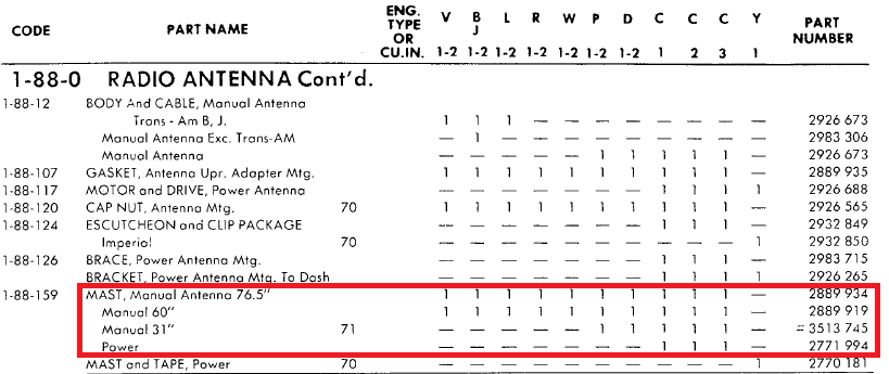

Hi everyone,
I just found out that there's a big difference in antenna mast height between 1970 and 1971.
  • '70 has a height of 76.5" or 60"
  • '71 has a height of 31"
I'm just curious: is there a reason for that?
'71's used a fixed length mast vs. an adjustable height mast. No idea why they changed. Probably to save a few pennies.

As far as the parts book goes, the 60" antenna mast is the multi-section mast and the 31" mast is the fixed-length stainless steel mast.
