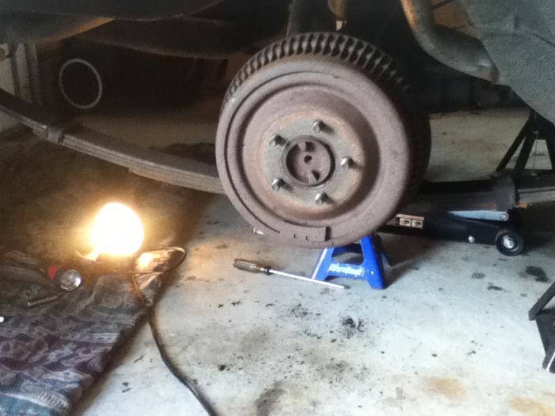

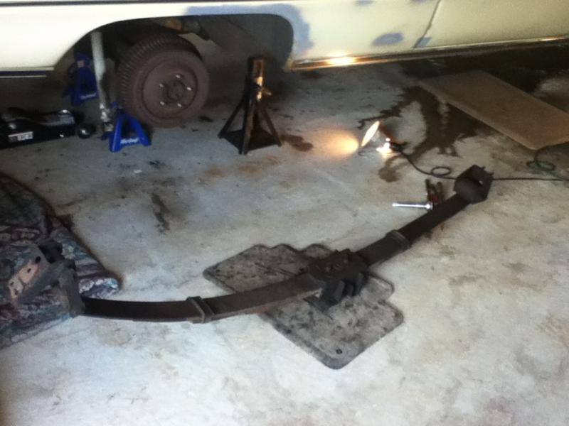

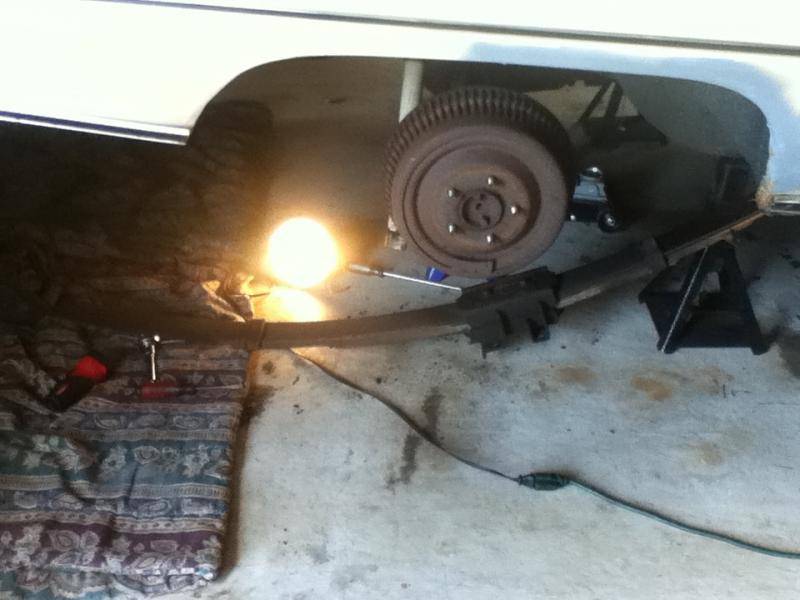

...and so after a few delays, it begins. Everything is soaking in PB blaster for a couple days, got fire wrench at the ready by my side. Gonna see what might feel like loosening up tomorrow.

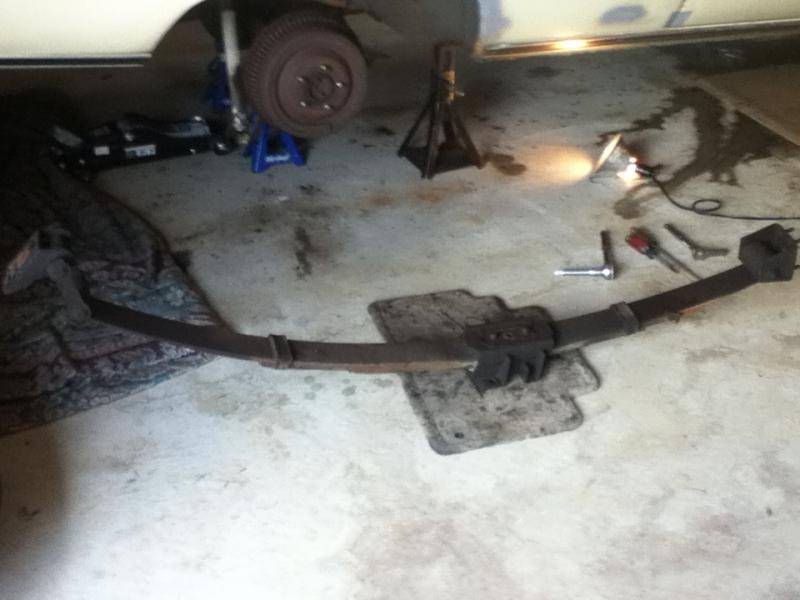

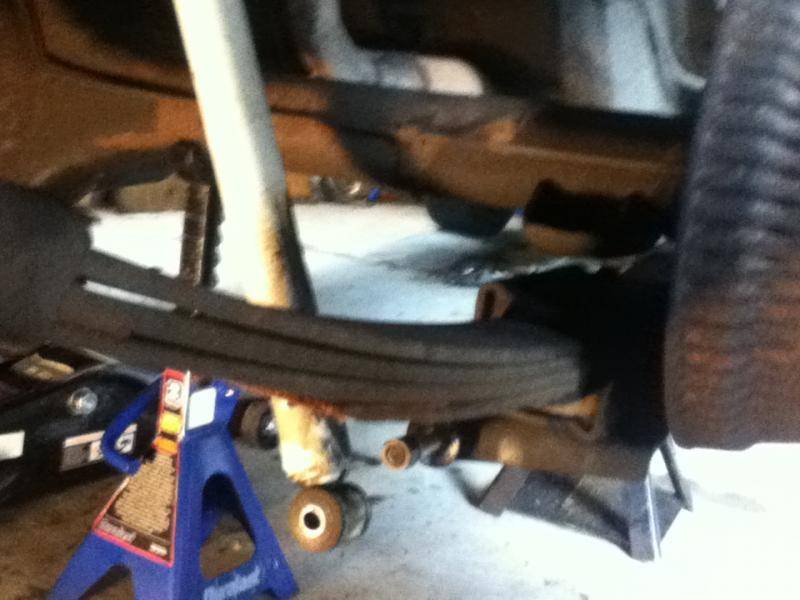

I did mine a couple weeks ago. One piece of advice I have is to take the front spring hanger out rather than screwing around with the eye bolts in the car.
Also.. I should have said this in my other post. Don't fully tighten the spring eye bolts ( you did buy new eye bolts..) a little snug, but loose enough to let the hanger pivot. Same with the shackles.

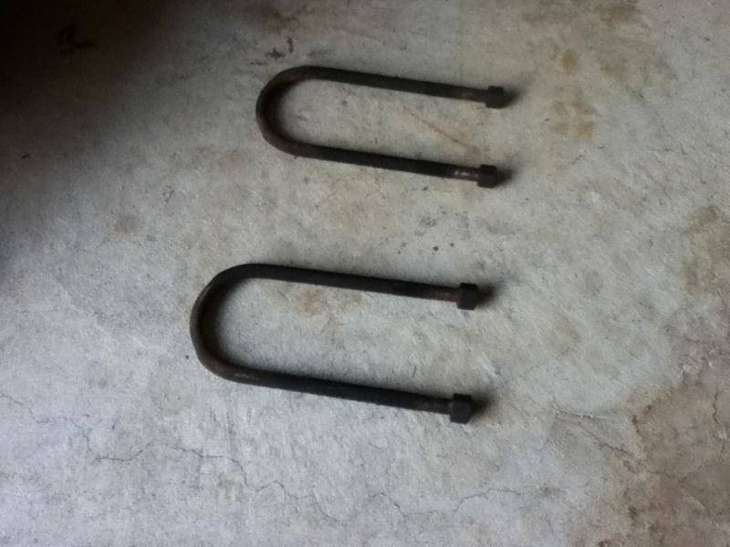

Get the u-bolts good and tight and jack up under the axle until the weight is just off the jack stands. Then tighten the front spring eye and shackles. This lets the car get into the position it will ride at. If you tighten everything with the rear axle hanging, you stress the rubber bushings.
That makes a lot of sense. I was looking at those last night wondering if I should try that rather than messing with the eye bolts while the spring is still bolted in the car. Yea..all new bolts, rubber, nuts, u bolts...everything but the rear shackles...like Dave mentioned they are not straight and the spring place did not have the correct ones for my car so I'm gonna have to reuse them.
John is right, drop the front hanger.

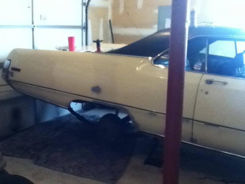

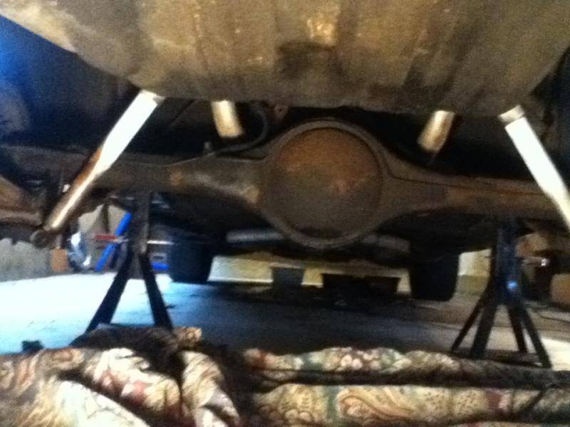

I loosened up everything first then unbolted one by one.. When not cleaning up the rear and just replacing I have the car body on stands, the rear on stands and my lone jack under the center of the spring, once everything is disconnected I lower the jack slowly....... I believe all this was said before by John but it bears repeating.
The last set I did I got sloppy and almost lost an arm from being careless and trying to get done.
I used a torch on a few things and the extinguisher was right there

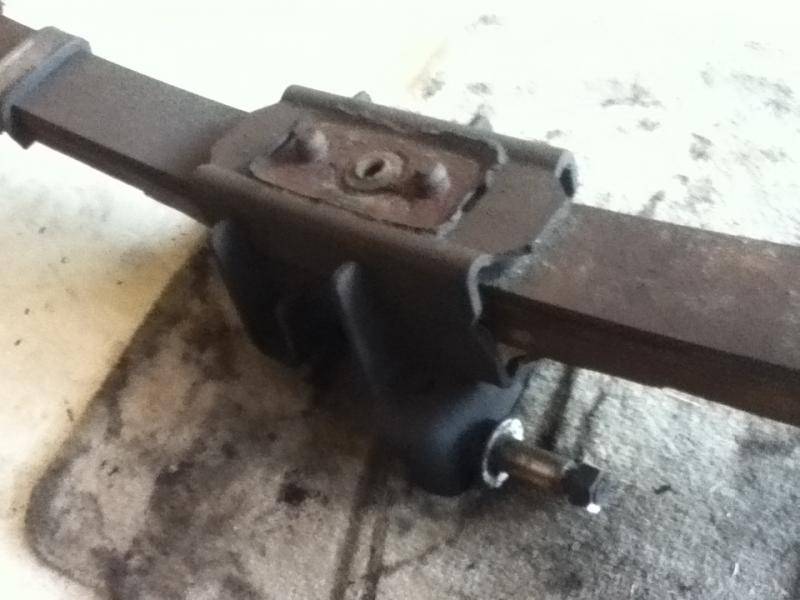

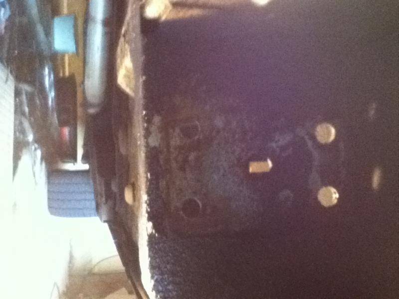

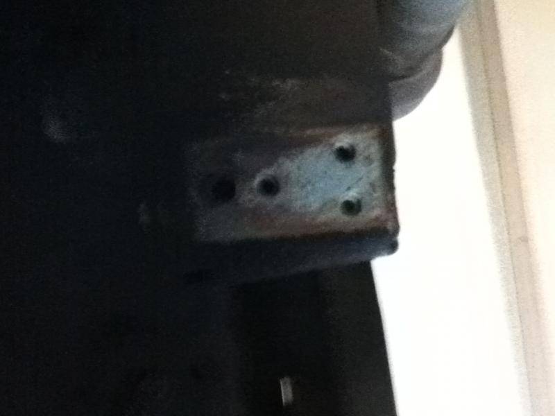

.............. are those brackets holding the isolators just supposed to come off?? I think they will need to be pryed off...
