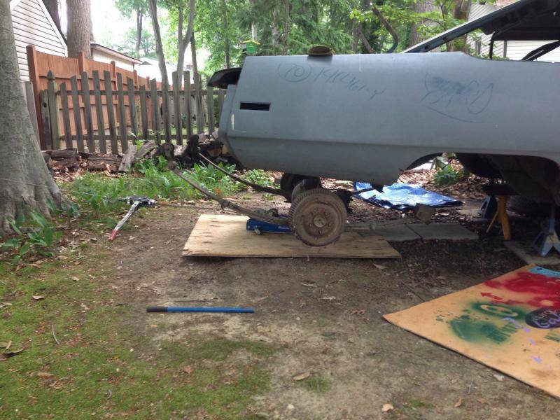

Not sure if you are planning to roll the axel and springs out as one unit, but that's how I did it. One thing to remember is to jack the car up high enough so the tires clear the rear bumper. You might even have to remove the rear valance panel. Took a couple of tries but I eventually had to remove the wheels and drop the whole thing down and roll it out with the jack. I soaked the forward bracket bolts for a week with PB Blaster and I still managed to snap two on each side.

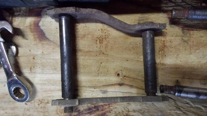

Gary, your springs and brackets look like what is under my 71...
And to my research there is no reproduction shackles for our cars, unless I missed something . Laura was also surprised to see the shackles that we have. She has been selling people straight shackles without the offset and no one has said anything. My bolts snapped and I had to source used.
Thanks James. Not sure. Is that the best method? Is it possible to remove each spring without rolling out the entire assembly? (axel & springs) like in your pic? I don't think I want to drop the driveshaft if its not necessary. I have plenty of stands and a jack that will get the *** end up high enough. Another mopar friend says he uses a torch to heat up and expand difficult nuts/bolts.
All a matter of preference, I needed to work with the differential so it all came out. You could certainly support the axel and drive shaft and pull one spring at a time. More time on your back, but it may be easier putting it all back together.
I prefer the one spring at a time swap. To pull the diff you'd remove brake line, parking brake cable, and unbolt the spring perches front, and rear. then you'd need to re bleed the brakes.

Jack the car and get your stands under it. Floor jack under rear axle and lift so there is no tension up or down on the spring. Unbolt the U-bolts followed by the shackles. Drop the end of the spring on the floor and then work on the front.
To install, reverse, but I like to jack the rear up a little more and then let it down onto the center bolt.

Gary, unless you are going to clean it up and paint it or replace the center section there is no need to slide it out from under the car. I've done it both ways and I've found that one side at a time is more simplistic than full removal.
