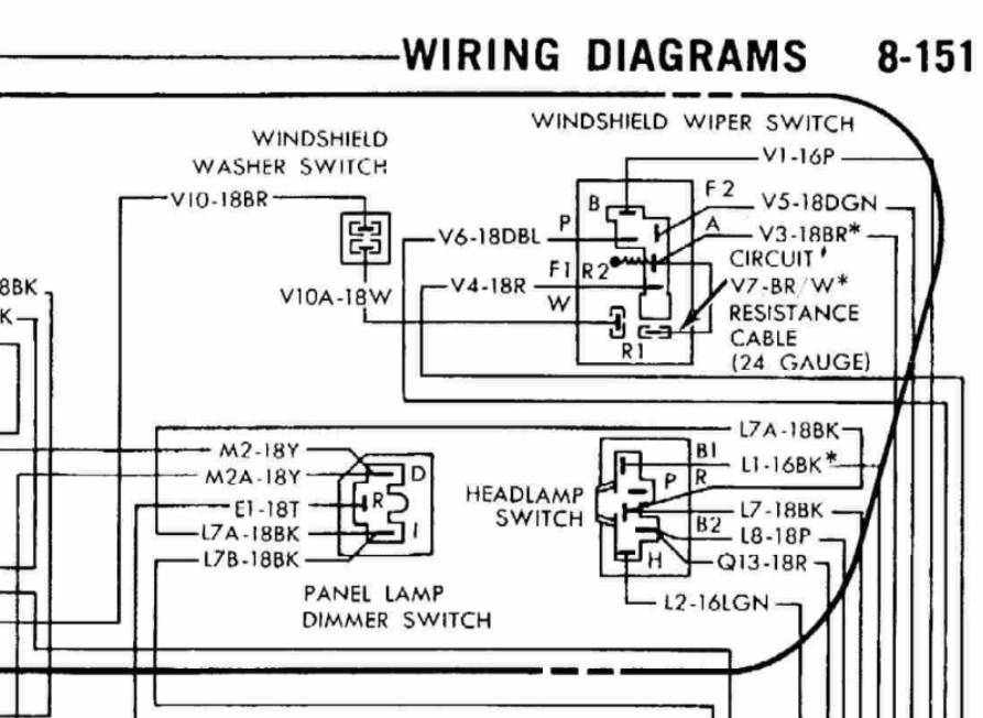

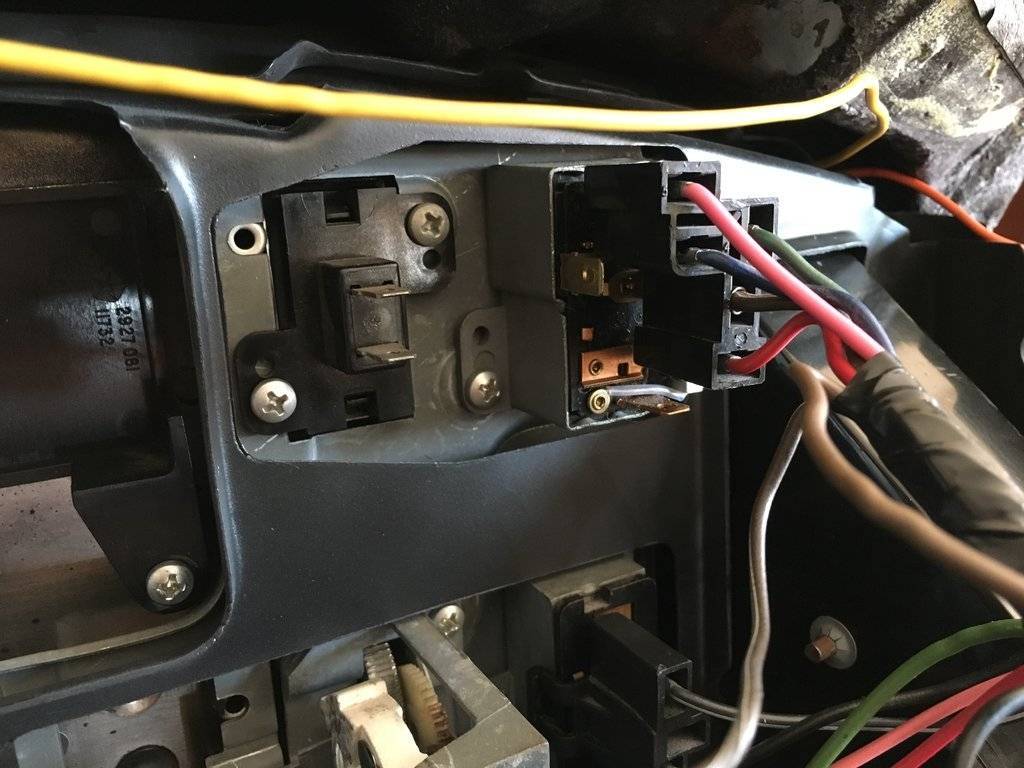

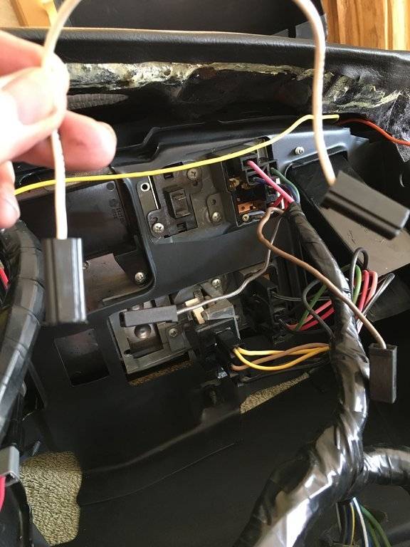

Ok, so I'm wiring the dash I'm on the washer button (2 prongs) and wiper switch (2 prongs remain). I have 2 brown wires and a separate white wire. What wire goes to what prong?
Thanks
I think I got it. The only question is, does the dark brown go to the washer button or wiper switch?
From the FSM. White wire goes to wiper switch and washer switch. Brown to washer switch.
