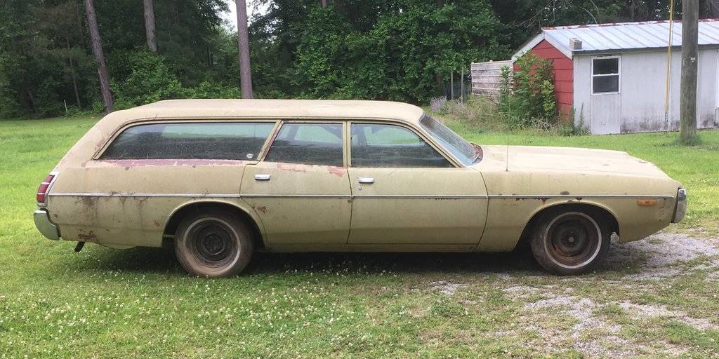

Loaded up & headed to Wollfen's shop. Gary is going to put new floor pans in it. Repair two rust spots in the body & install subframe connectors. Gary will take some pics of the progresss

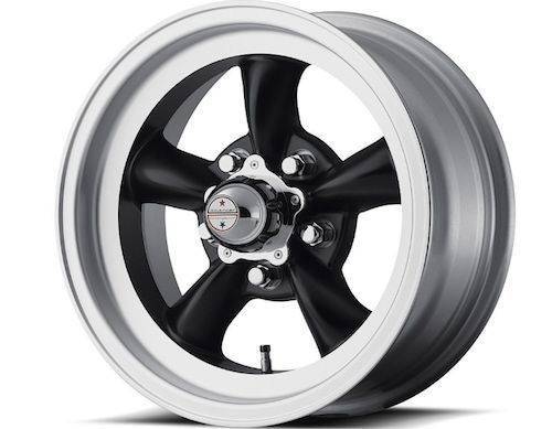

A set of Torq Thrusts would look great on this vehicle. At $384 for four of them delivered to your door isn't too shabby at all! Thanks goes to Snotty for posting this link!
15X7 AMERICAN RACING TORQ THRUST D BLACK (4) 5X4.5 VN1055765B FREE CHROME LUGS | eBay

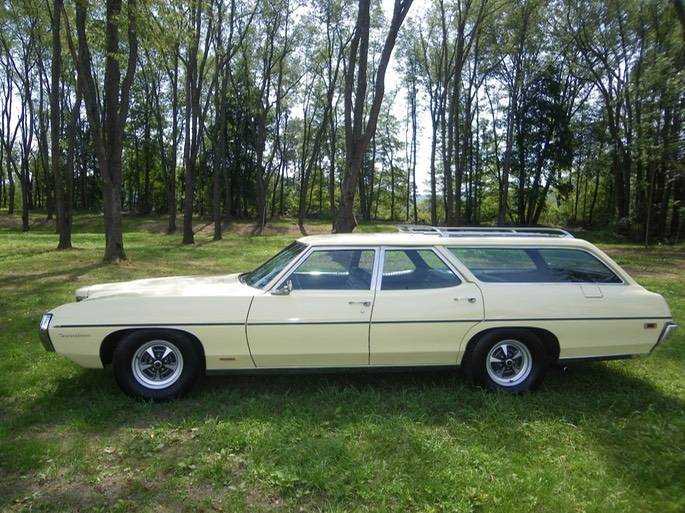

I already have a set of very nice barely used ones with tires mounted. Thinking my 66 Belvedere though. I likely will put my set of Magnum 500's on the wagon. This Pontiac is the look I'm thinking. With the shiny trim rings ofcourse

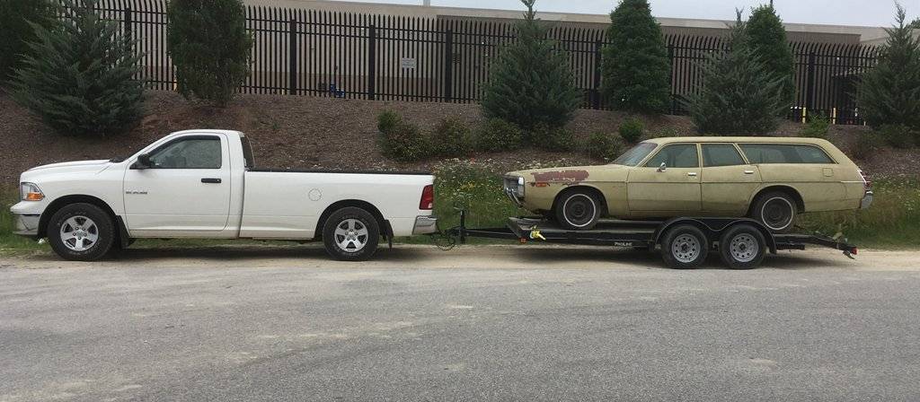

Arrived at Wollfens place & unloaded the car. A look around at Satured's cars (you got some nice cars Dale) & back on the road home

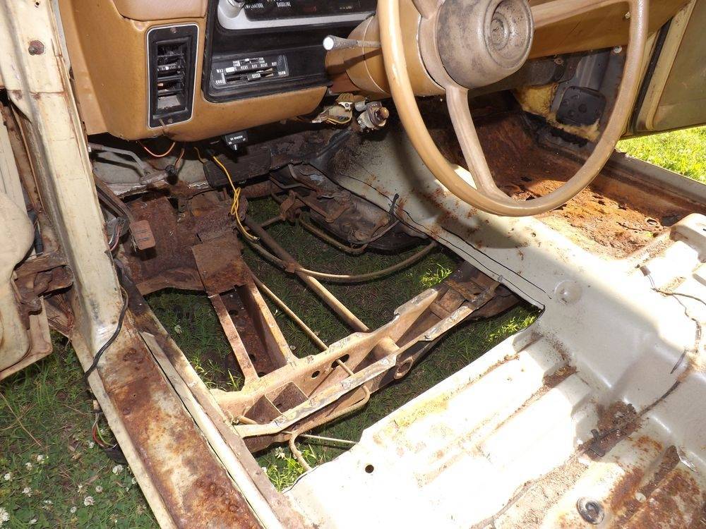

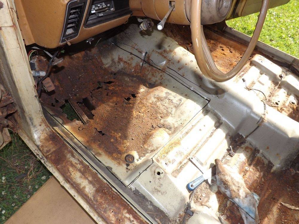

Alrighty, I dusted off the cobwebs and took a look at the car today, then I proceeded to clean out some stuff off the floor before marking where I would cut the pan out, That done I proceeded to remove the accelerator pedal and high beam switch, both of which I tucked away. Then it was time to do the cutting, then used my air chisel to pop the remaining welds. Check the pics, todays progress. It's hot so I am stopping. More to come soon.
View attachment 125621 View attachment 125622
WOW that looks good Gary. That panel just below the E brake, can that be treated with a rust product ?
WOW that looks good Gary. That panel just below the zero brake can that be treated with a rust product ?
Yeah sure, my next step will be to grind the spot welds down and clean out the chassis rail of all the scale, then I will use the chassis sealer I have on all you can see, then use weld through primer on the spots where the new floor pan will be welded onto the chassis rail flanges.
