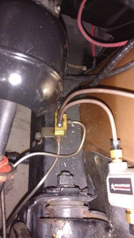

The brake conversion turned out to be a pain, but none of it was from what I currently installed. 4 years ago I installed a dual master along with a new distribution block to accommodate the 2 inlets. I installed the distributor backwards. The result the rear line went to the front RT and and the front line was distributed to the front LF and rear.
It always pulled to the right, and when I added the discs and dual power booster it was now undriveable, until I discovered the problem.

Here was my problem it was reversed.
