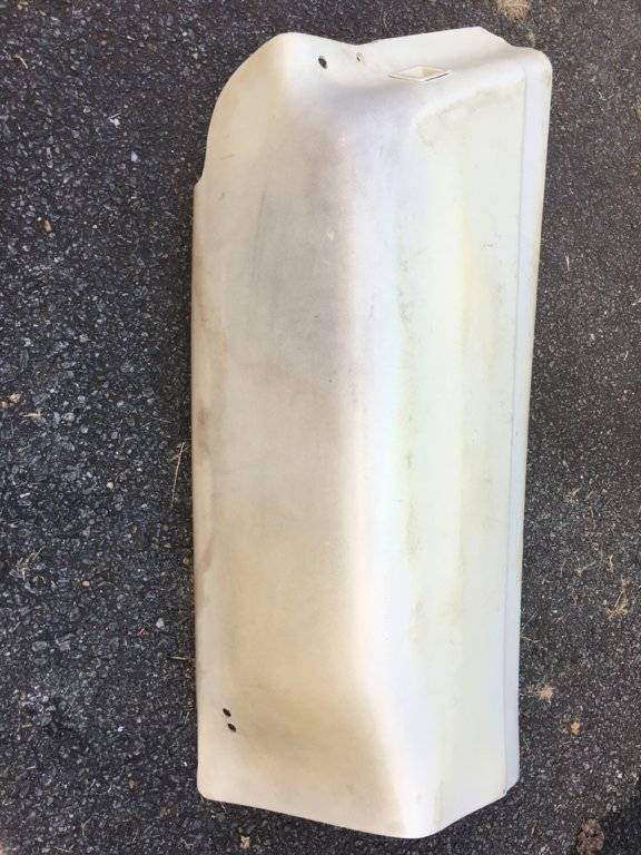

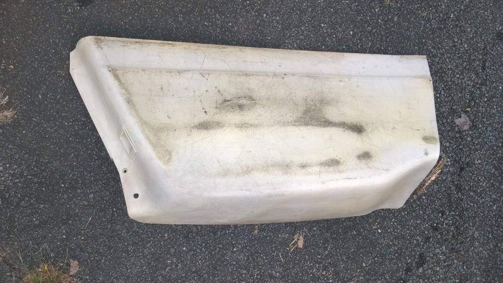

Cleaned thespare tire cover cargo panel. Before and after.
The dirt/stains were very ‘set’. I used concentrated dish soap, then I used orange hand cleaner (just a little grit), and then I used some PB Blaster to dissolve the serious black stuff. Then I used the soap and water to get all that off. Soft bristle tooth brush, wash cloth, and soft bristle wheel and tire brush, also.
I think the previous owner may have hauled photocopier equipment in this? I found a random “Ricoh” plastic cap in the car. Maybe the black stuff was toner or ink stains. I dunno. Ancient history.

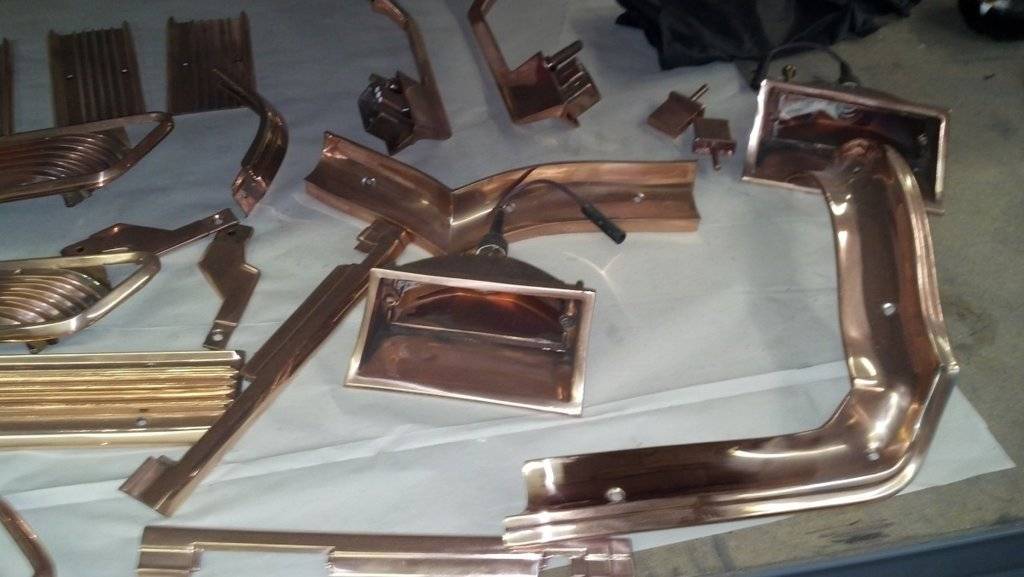

Here is some of the work I had done from them. They can also lay in paint if it is required.
I found a before picture on the pot metal. They strip down all the pitted metal then build it back up with copper, so the second picture shows their work just before chrome.
