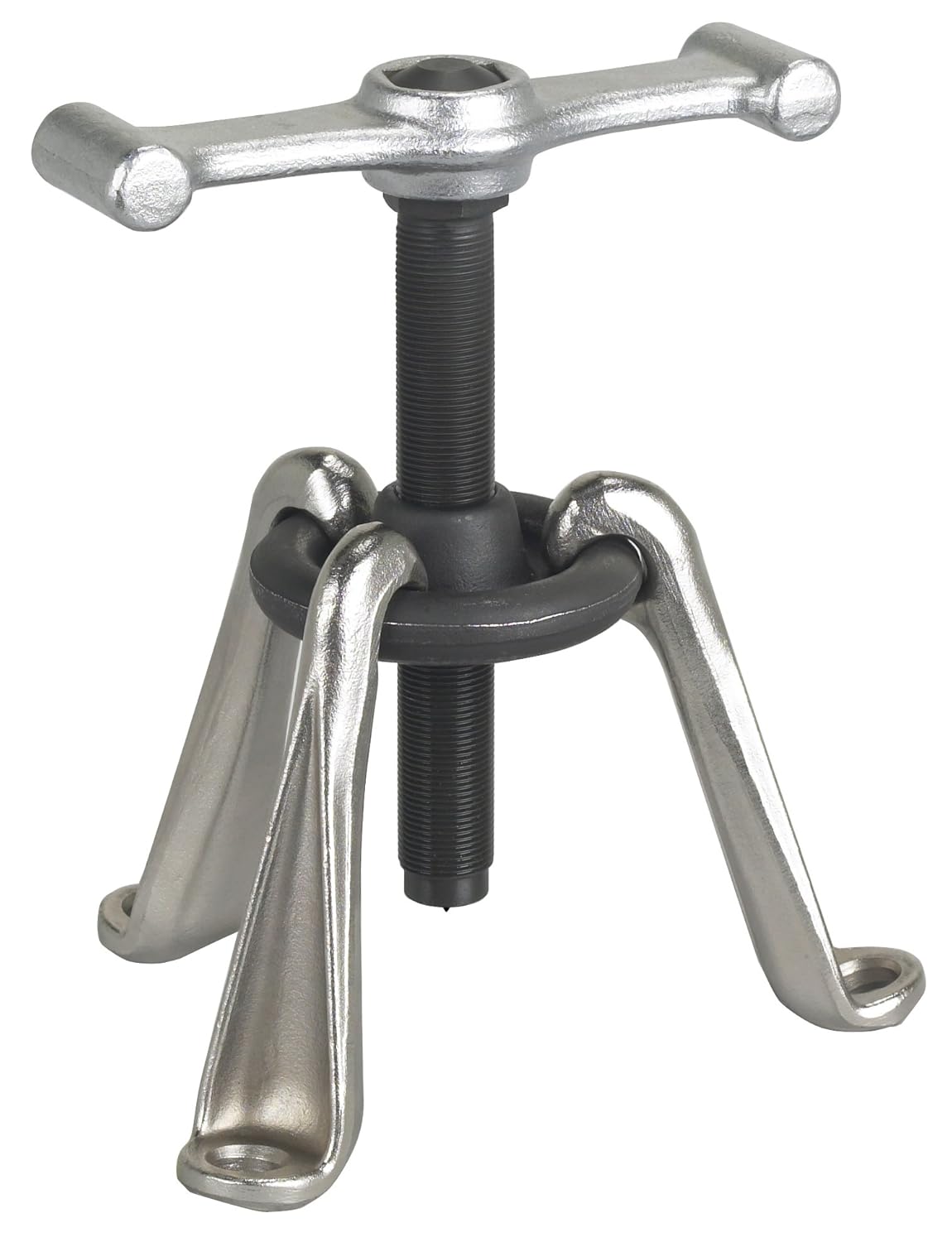

Is this a splined axel or a later model. The earlier splined you will need a specific puller to get the hub off. The later model has a bolt on retainer that is accessed through a hole in the lug flange.
Hi Virgil, 70Bigblock is right, if the car is 64 or older it will have the splined axles in it requiring a 120 ton puller. If it is a later car, each side has 5 nuts in the flange holding the axle in, sometimes it's easy to miss the bottom nut.
