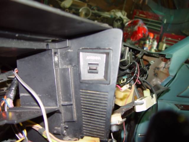

Does it have a power antenna switch to the right of the radio? See picture.... that is what the dash looks like torn apart. There isn't a step by step guide to take the dash apart. I do recommend getting both FSM's and the Parts Manual. You can get them on EBAY pretty cheap or you can get them on CD. I'll post the link in the next post.

Major pain to replace the antenna. So if it works...leave it alone. You would have to find a donor car if you wanted a power antenna. You would need a switch (plus cut a hole in the dash like I did in the picture to mount the switch. You'll need the wiring harness and the power antenna assembly. You have to take the right side inner fender off and (to me) it was easier to take the hood off. Like I said it is a lot of work. New parts are not available.

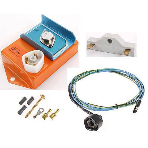

Here's the one you want to get. It's getting hard to find these kits.
Electronic Conversion Kit, 426 Hemi, 426 Wedge, 413/440 Big Block. #P3690428
From what I've read, the Mopar Performance distributors made since 2000 and on have a unstable spark advance at idle. I wouldn't be surprised if they are not making the distributors anymore.
The last time I did a conversion, I found a used distributor and bought a kit like this to do it.
Mopar Performance P4120505K, Mopar Performance Electronic Ignition Conversion Kits | Mopar Performance
If you don't like the used distributor idea, you can also buy a re-manufactured one from your local auto parts store.
Thanks. But do you mean to say that the kit suggested by the "old man in a hat"
JEGS Performance Products 40504K1, JEGS Mopar Electronic Ignition Conversion Kits with Forged Distributors | JEGS Performance Products
should not be purchased? And that your suggestion of Mopar Performance P4120505K, Mopar Performance Electronic Ignition Conversion Kits | Mopar Performance plus a remanufactured distributor is the best route to take?
Sorry for being confused.
Yes, easier to go to your local auto parts store for the re-manufactured distributor for an older pre-lean burn Newport and purchase the Mopar Performance kit P4120505K.
