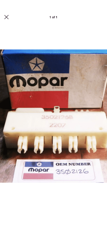

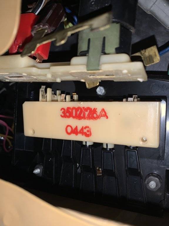

My vacuum switch broke on the heater and a/c control box. Mine is the first one pictured. I can’t find one on EBay that has the same numbers listed in red at the bottom and the top number is off by one letter. Do I have to find one that matches the numbers on mine or do I have some other options?
View attachment 356793 View attachment 356794
There were several minor variations of this switch, usually involving improvements, as long as it is correct for the application it should work. You have a 5 button switch and the replacement is also a 5 button unit so it should function the same.
Dave
Dave
Thanks, Dave!
I don’t want to shell out the prices they’re asking for on eBay and end up getting the wrong one.
Daniel
