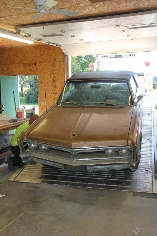

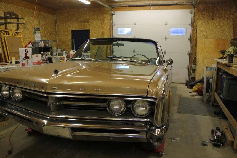

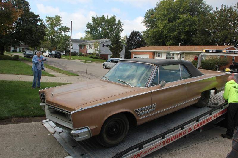

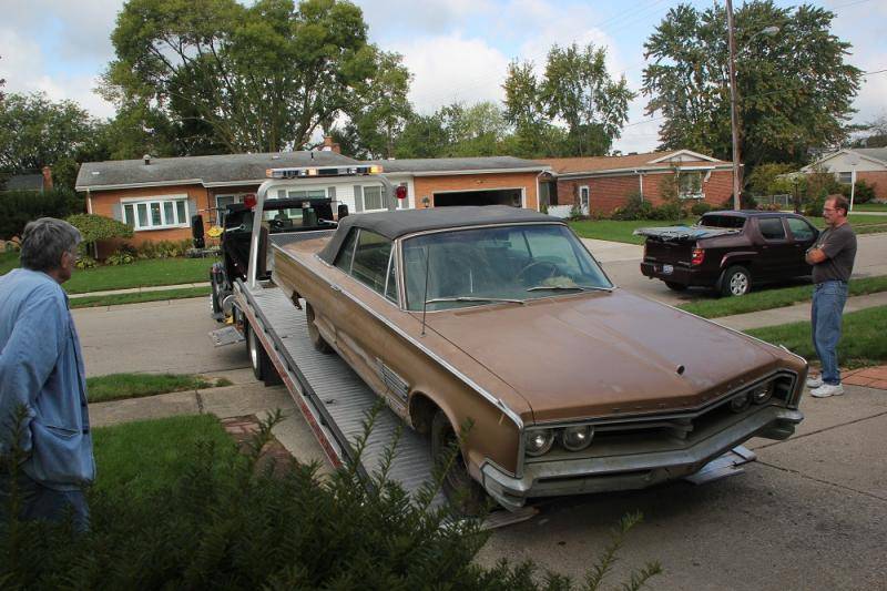

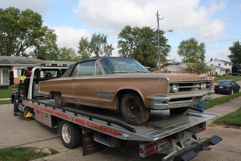

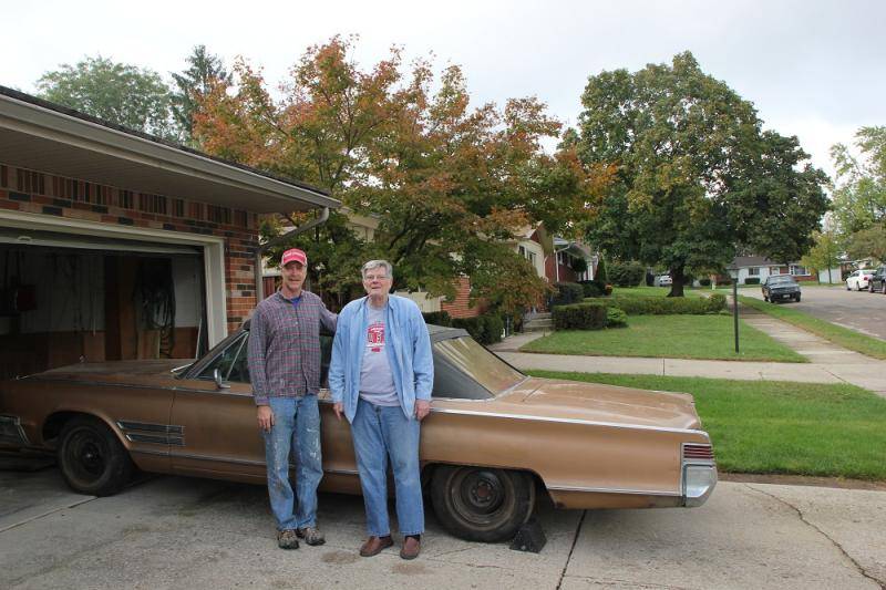

Moving day. I had a great guy towing my car to its new home.

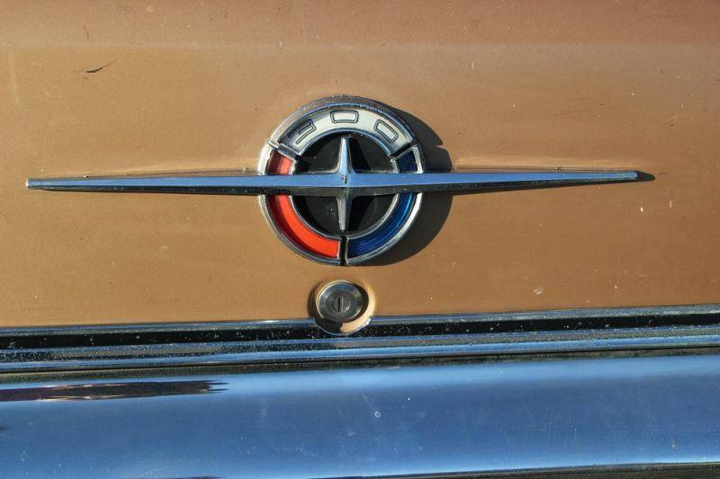

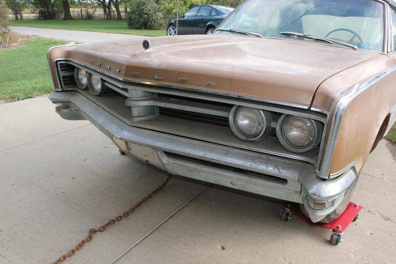

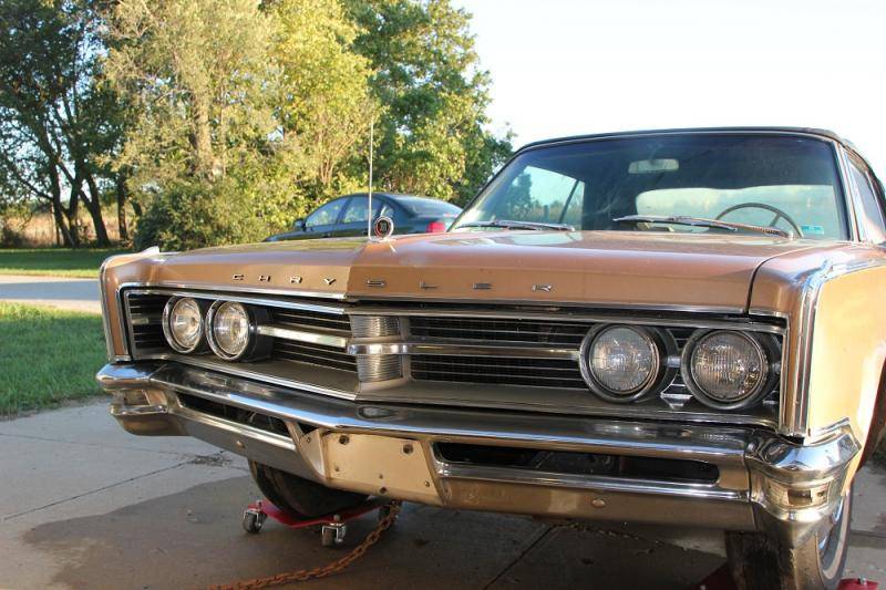

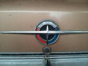

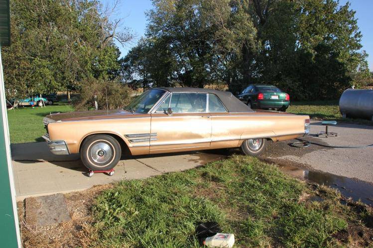

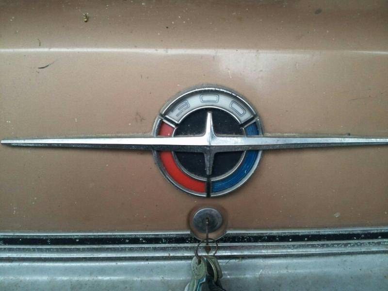

Here are a few before and after shots. I worked on the chrome a bit. I haven't tried buffing out the paint yet. The paint is one that looks OK from 50 feet. I bet there are at least 4 or 5 different touch up paint colors and none of them match the original paint'66 Chrysler 300.jpg

I was the event yesterday morning in the neighborhood. Two guys had to leave when the tow truck came, they were blocking his way. It was funny the older gentlemen were saying your wife is going to be so glad to have a spot in the garage. The "younger" guys where clearly jealous of me once they saw the condition of the car and that beautiful front end, that literally no one had ever seen before, because his garage was clear full.
