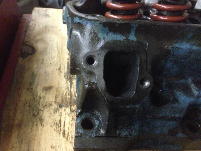

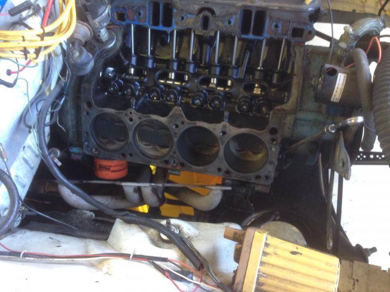

Had to pull a head today. Hopefully I can have it back together for next weekends races
Went to warm the engine up & had a major header/exhaust leak. The rear stud had sheared off somehow. Going to call my buddy tonite & see if he can drill it for me. If not its off to the machine shop
Hardened stud broken off below the surface...Arrrrggghhhh!
Yep it was one of those WTF moments. Never heard of this happening before. Funny thing is I looked all over the floor of the shop and I can't find other end of the stud

Looks like you have a descent amount of lift on that camshaft :)

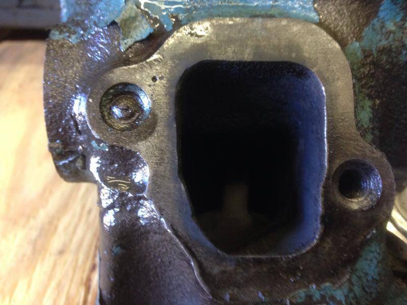

Whew! Well my neighbor who is one of the best true mechanics I have known got the broken stud out. So looks like Saturday before I can start putting it back together.
