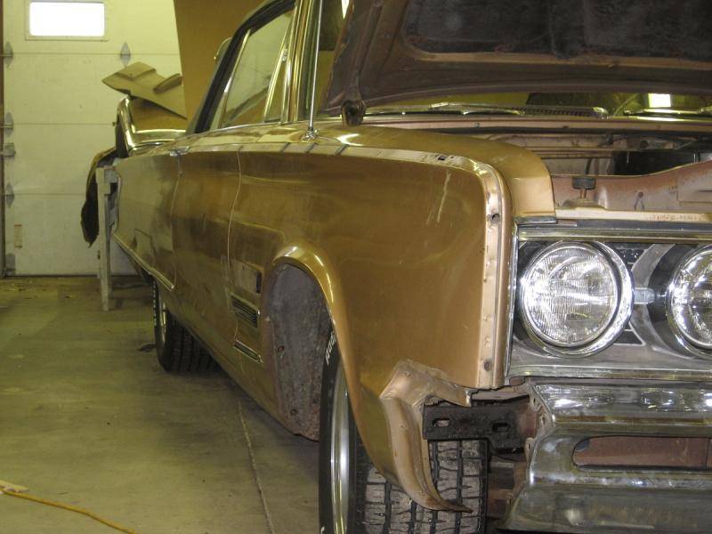

I am now an expert a removing trim from a 65-66 C-Body. I have a whole new respect for a real auto paint guy. I have painted my vans over the years, first off they have virtually no trim, but what little they had I would just tape off and go. I thought it was a big deal if I spent nearly a day prepping and taping.
I have spent about a total of 8-10 hours removing the trim so far and I might be a quarter of the way done. It has been a lot of trial and error, but so far so good and I haven’t broken any clips. I think I know the approach on most of the trim left to remove because one side is almost all off, so the rest should go a little smoother.

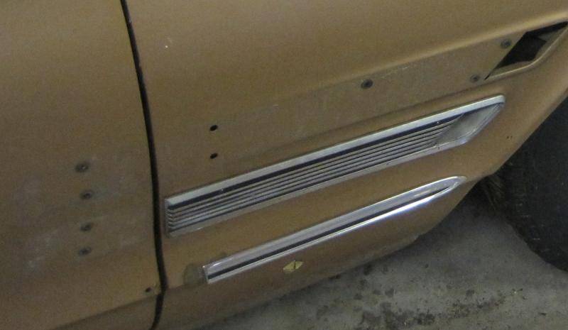

As you can see I am far from an expert yet on removing the trim. My last item that has been stumping me is the 300 trim on the front fenders. They are screwed into hard rubber gourmets. No rust breaking fluids will release the screws because they are not rusted into place. I am starting to strip the small Phillips head screws. I have tried prying behind them while unscrewing but not luck.
Should I just drill them out and be done with it?

You would be best served in removing those when the fender is off the car.
