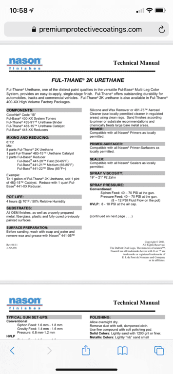

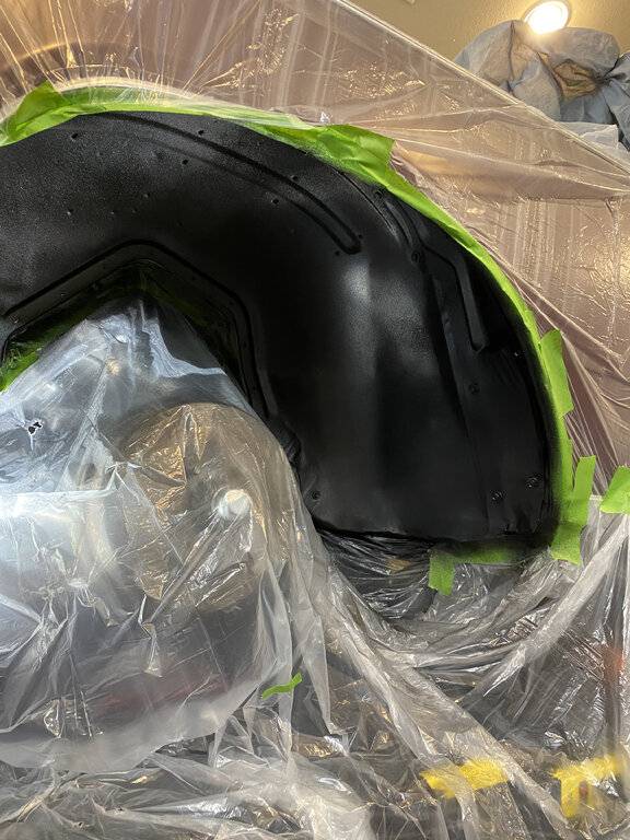

I have just undercoated the tire side of my painted inner fenders. I cleaned, degreased, cleaned and scuffed the surface before applying TiteSeal paintable undercoating. After about 3 good coats and following the instructions to wait until completely dry before painting, I am getting ready to top-coat. As in the title, I am using NasonFul-thane 2K SS Urethane (I think used to be Du-pont) to topcoat.
What I cannot find is whether to prime the undercoating first, use adhesion promoter as if you were to paint on plastic, or the undercoating acts like a primer and can be directly top coated. Any experience in this matter or working with 2K paints would be appreciated. I did search the safety data sheets and instructions for the undercoating, pretty vague.

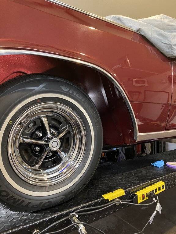

The deed is done. I am happy so far. I will look at it tomorrow when it is fully dry.
I found some grey sealer, which is much easier to cover than black.

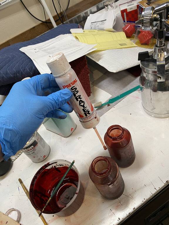

Since it was a tight area, I used a little Prevail spray system. Mix the paint, pour it in the jar and add the aerosol top. Decent pattern like a regular spray paint can. The paint supplier said to use a little more reducer than you would in a regular spray gun. Seems to work fine.

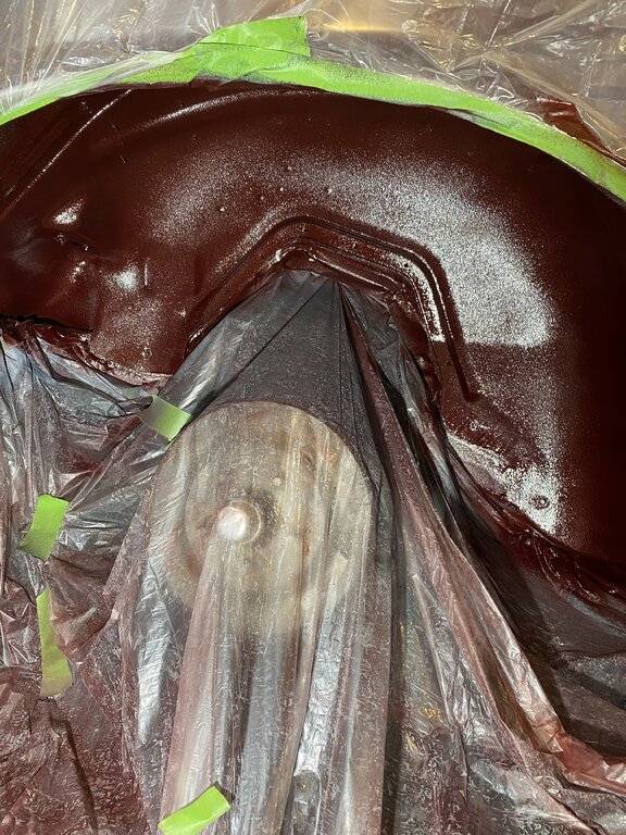

Masking off and tires back on. Supposed to be around 50 degrees by Friday. I may have to take it for a spin.

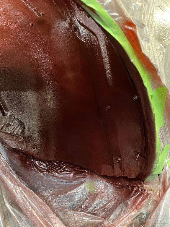

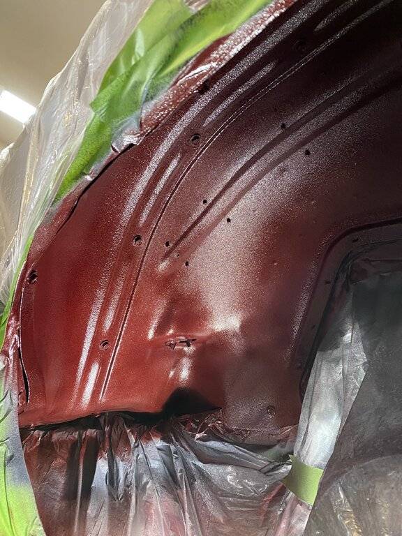

The metal flake under there may be a little heavier than on the body, and very shiny. It actually still looks wet, but is dry.
It is a wheel well. It will dull down soon enough.
First picture looks like overspray on the wheel trim, but is just a reflection, must be too shiny.
