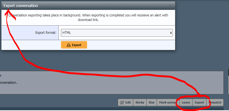

Well, my inbox is full and I don’t know how to delete them! I’m so dumb!
'Leave' if you want, and there are options to accept future messages. Although I don't know what happens if every participants 'leaves'.
If you want to retain the info, you have 2 options (that I know of):
You can 'export' and the website will make a file for you, that you need to wait on.
Or the far-easier thing is to do is the 'ole CTRL+S and save it as a webpage on your PC, in wherever and whatever file format you want. (I'm a fan of single-file for stuff like this)
And you don't have to wait on anything.
Afterward, 'leave' to conversation and it's gone from your inbox.
