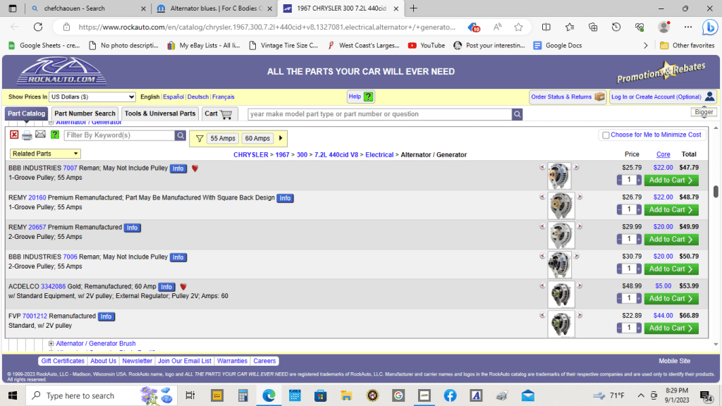

Rock Auto is OK. I like the roundbacks. You're trying to keep your setup looking original? I do well on eBay, or fish locally. How big is the charging wire? That tells the ampacity of your alternator. If its a 12 gauge, get a 30-50 amp alternator. If its a 10 gauge, get a 60. I ran AutoZone alts for some years, simply because they have their warranty. Theirs last a year or so, usually, after making sure its not DOA.

Finding one seems to be my problem, mine is round back, single field. NAPA had that style, single pulley for truck?, was 45 amp. Prices $65-$225! Car has electric seats and windows with a/c, I would think at least 60amp. At least I can still get the mech regulator.

I just used 67 as the year .
1967 CHRYSLER 300 7.2L 440cid V8 Alternator / Generator | RockAuto

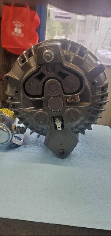

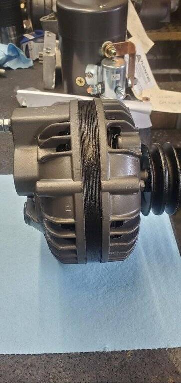

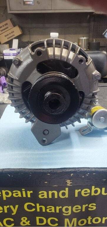

My original was seized solid and I thought I’d just replace it, but couldn’t find one anywhere that was the basic lower amp, round back, two pulley. Then I came across a local rebuilder and for $150 it‘s like new.
