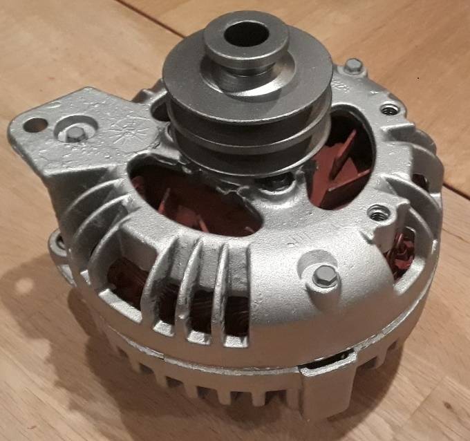

I have a remanufactured "squareback" 4091424 alternator, upgraded to 90Amp.
Have had it on the shelf for a decade now.

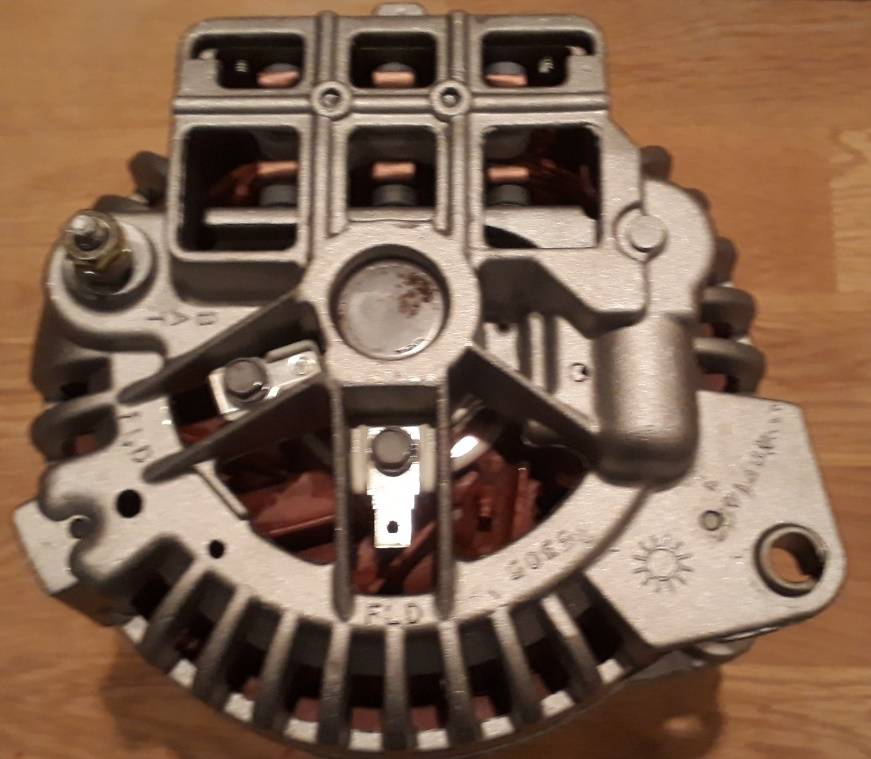

Do this have an internal regulator or does it require an external?
Lost the receipt, only a part found were it says: 90Amp fits 63-87 Mopar
That alternator is setup as a pre '70 single pass alternator and it needs a regulator. It came with the mechanical type, but there are aftermarket electronic ones that will work. The second field terminal that is turned around is set to ground for a mechanical regulator. You can take the screw loose and turn the terminal outward to make it a dual pass unit that can be used with the '70 and later electronic regulator.
