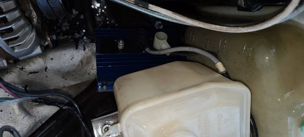

There is this box and I am unsure of what this is or if it is supposed to even be there.
Starter relay?
Ballast resistor?

Hi The "Box" you are wondering about is a battery isolator , inside are a set of two Diodes that ensure that power flow is from the battery / Alternator to the load (the car electrical system ) . The other Diode feeds the trailer tow wiring. This item should cause no issues as long as the connections are clean and tight and on the correct way! By your description about the 440 cranking slow and "dull" I would say check the starter. The starter is designed to operate at a nominal value of 11 volts , with a current draw of around 90 amps.

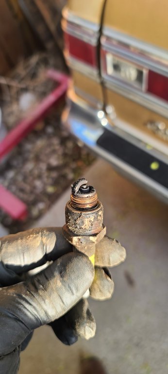

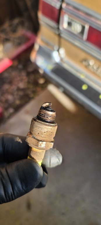

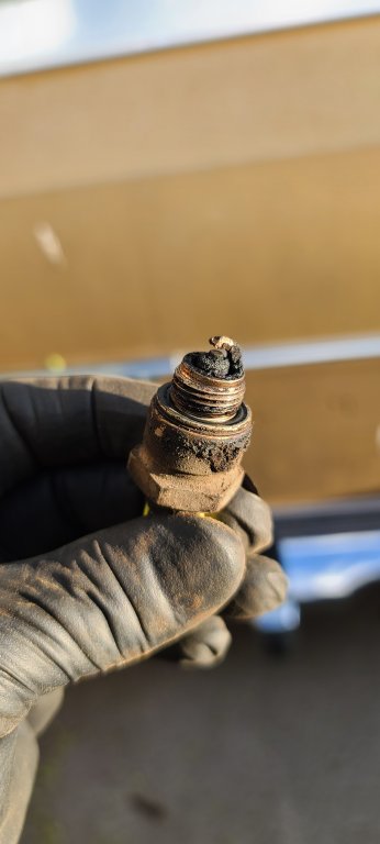

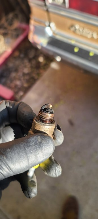

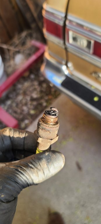

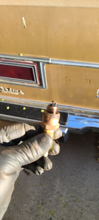

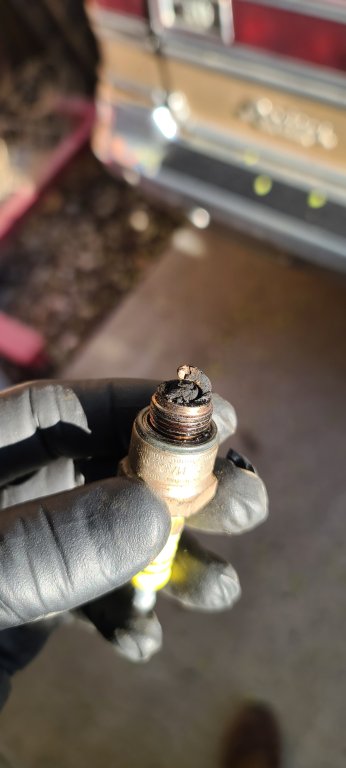

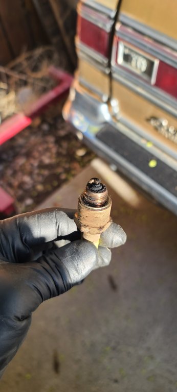

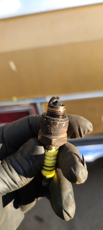

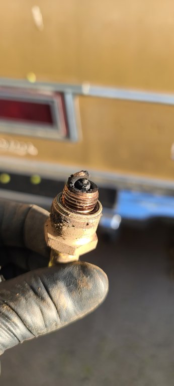

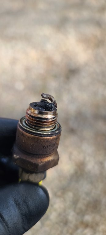

Since this was indeed the issue I had better post pictures of the problem.
These accel shorty plugs are the worst plugs I have ever purchased and installed on my 440's in the past.
the lead that connects to the wire ALWAYS come lose. The only way to get them to not come lose is to squish them before installing. Even then it doesn't seem to work.
These were very very dirty.

They look oil fouled. Run from those Mopar Authorized ignition kits, the curve is fast and the ECU's are junk made overseas.
Are those cold or medium cold plugs? I was burned by that once. Is the engine modded? You said you changed the plugs. What did you put in there?
