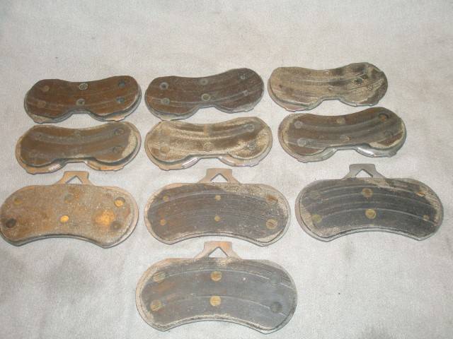

Anybody know of any companies that can re line disc brake pads?
I have quite a few pairs of BENDIX, and BUDD, disc brake pads, that can be put back into use if new lining material can be put back onto these cores.
I know there are heavy duty truck shops out there in the USA, that reline clutch's and drum brake shoes, so the same thing can be done with disc brake pads.
But i personally don't know of any companies that i can contact.
Anybody know of any?
These BENDIX, and BUDD pads are awfully pricey to purchase, when you find somebody with new old stock parts.
Thank's.

Two problems you are going to encounter with relining them…. If indeed, they can reline a brake pad, period….
# 1 ) Those types of outfits are under the watchful eye of the EPA, which means they are going to have an issue with relining it in *** N.O.S. *** Asbestos *** which means that they will rip the Brake Rotors to smithereens, and you and I know how expensive those Brake Rotors are !!! I am pretty sure you know that I have the “ B “ body and “ C “ body ROTORS and we both know that neither is a $ 35.79 Chineseum Rotor…….
# 2 ) The price that they might want to do that is going to be prohibitive—- by the time you are done with what they want to reline them, plus shipping out and back, you might have to charge an arm and a leg for a set…..

I have been using Rochester clutch and Brake for my brakes and clutches since 1982. What year is is now? 3d generation family business btw. They can reline anything that has a friction lining. Custom clutches too...Imagine that

I'll be contacting two of these companies that have been discussed here, and if and when, they get back with me, i will post my findings, here in this thread.

UPDATE:
The Rochester Clutch & Brake company got back with me, just telling me that pads are still easy to find on ebay, without giving me any kind of quote.
Guess they don't want to do them, or want my business.
Oh well, with that company.
Another company got back with me, and their charge would be $20.00 per pad.
So then, i guess it's still beneficial to find a vendor selling BUDD and BENDIX pads that's not ripping you off, price wise.

$20 a pad doesn't sound too bad, but if you can find them cheaper... For now anyway.
I'm surprised with the Rochester response. Their hype on their forum seems they want to do restoration business. But then... I happened upon this last night while looking for someone local to turn a brake drum. SERVICES | PBS Brake And Supply They also offer relining and advertise as "the only provider of in-house custom brake relining in the Northeast". Since Rochester is about 85 miles west of Syracuse, it makes me wonder if PBS does Rochester's relining...
That’s not bad at all considering the going rate for NO(R)S sets is around $110 to $120 per set.
