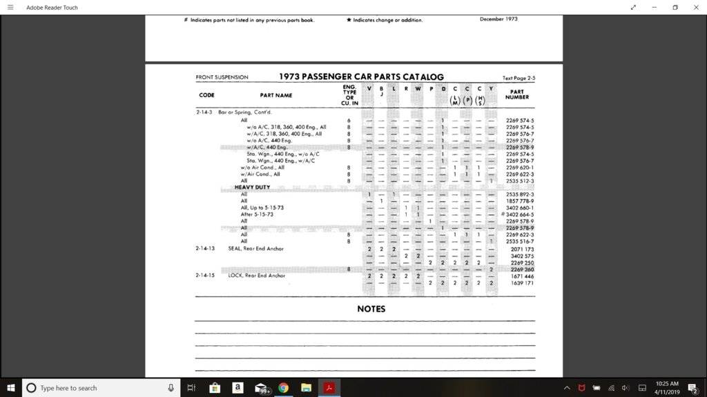

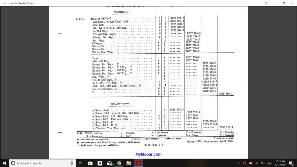

  13. Big_John
    Big_John Illegitimi non carborundum FCBO Gold Member
    Messages:
    13,283
    Likes Received:
    8204
    Joined:
    May 21, 2013
    Location:
    Marcellus, NY
    The numbers shown are the last three digits of the full part number.
    Screen shot from '68 parts manual.
    '73 parts manual.
    The diameter of the various bars are also listed in the FSM.
    They don't list a '68 FSM here, but I assume you have one if you've gone this far. They do list the parts manuals though.
    MyMopar - Mopar Forums & Information - MyMopar Tools/Reference
    • Thanks! Thanks! x 1

    Yes, I do have a FSM. And yes, the diameters are in there. I did not see them before. Thanks.
