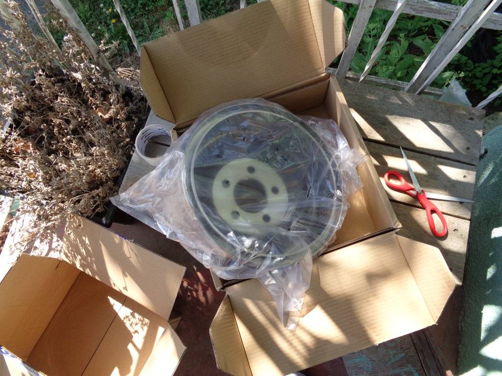

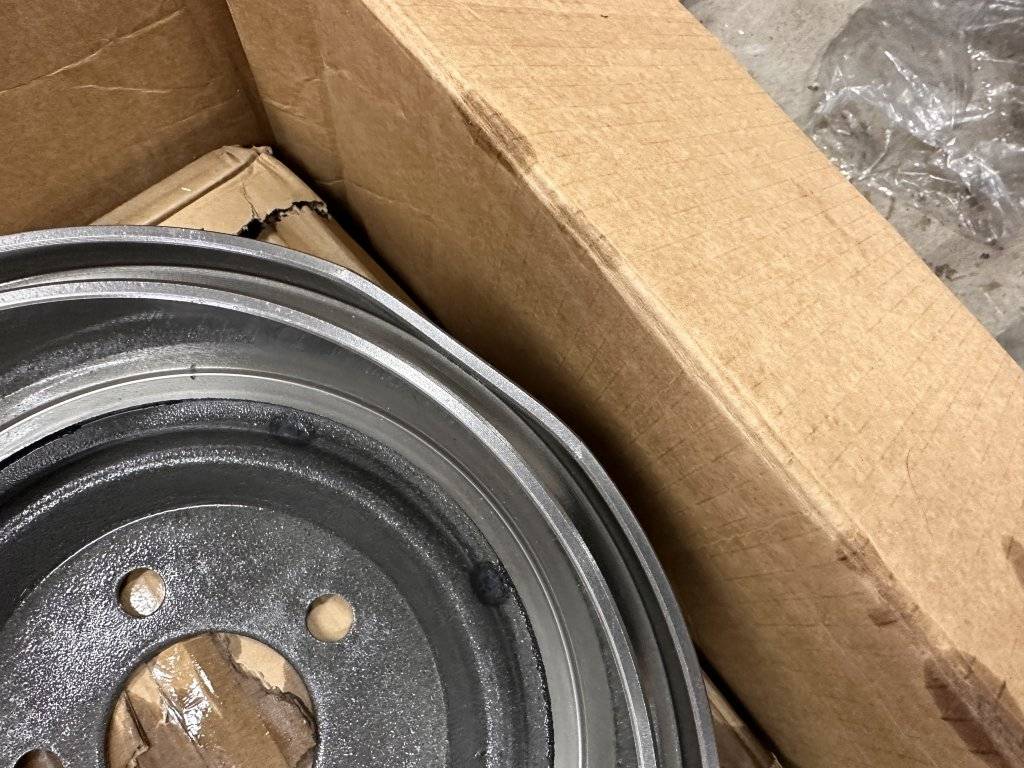

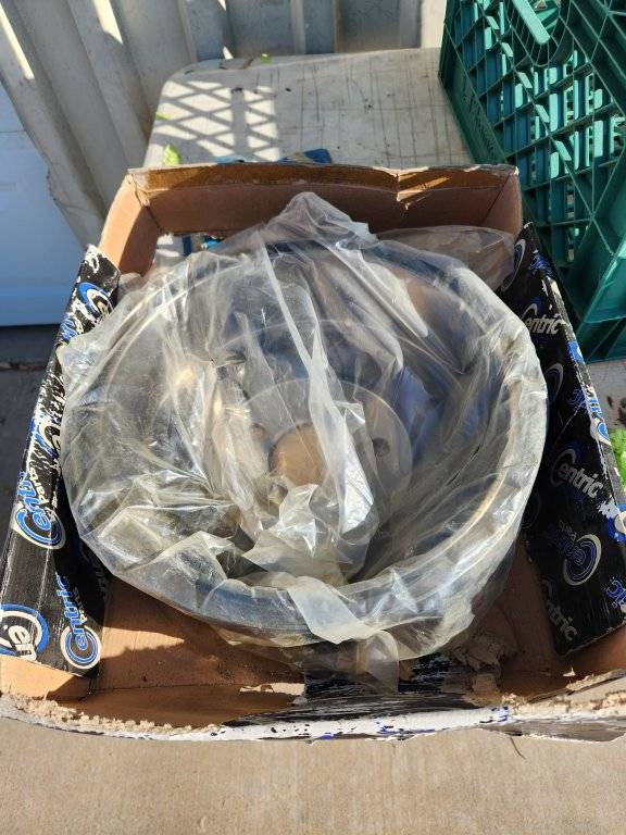

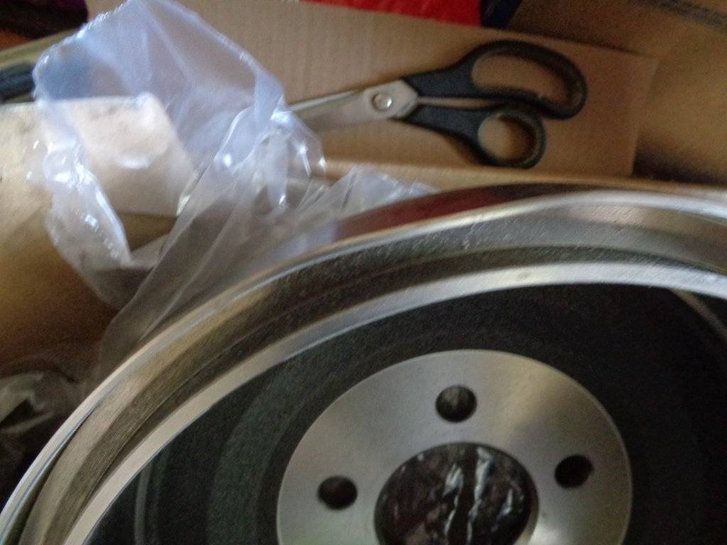

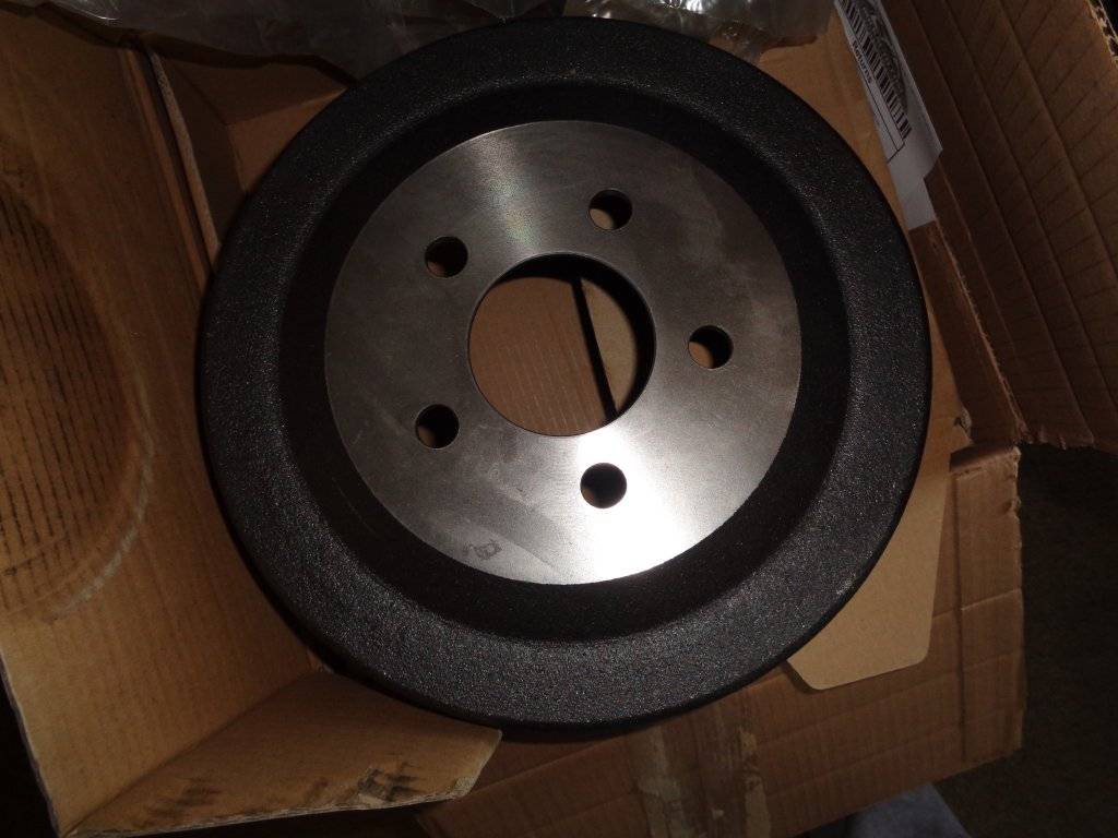

I ordered one from rockauto and it came not sealed in its plastic bag (bag ripped and stuffed under the drum)
and a big dent in it and NO BALANCING WEIGHT
The images of the drum show a weight and part number cast on the drum face.

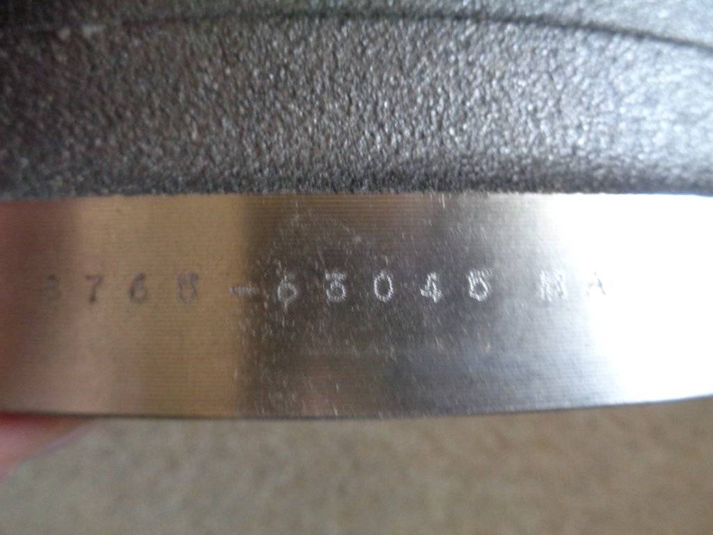

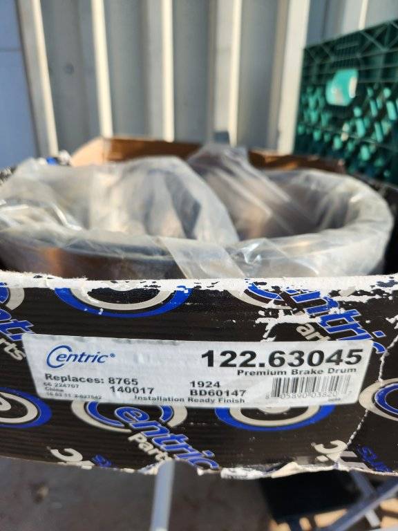

Mine has laser printing on the side with a centric part. Is centric "raybestos" too?
thanks

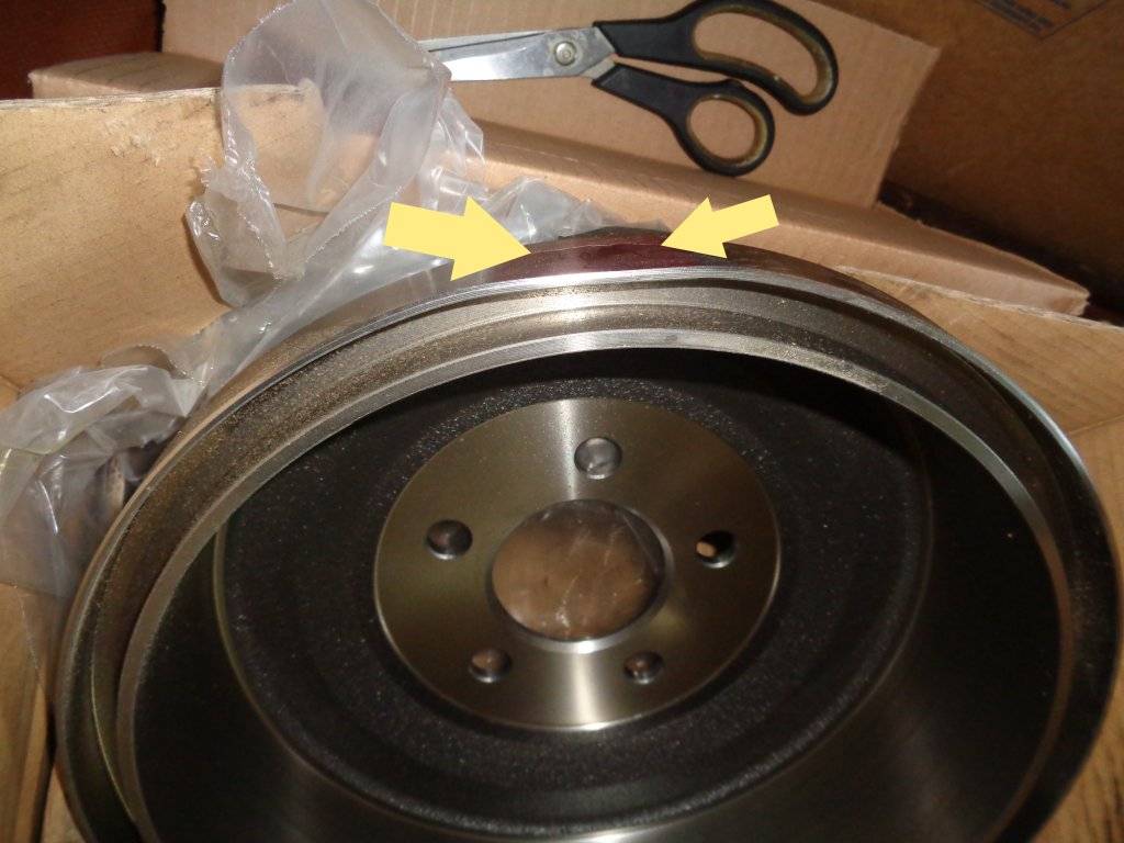

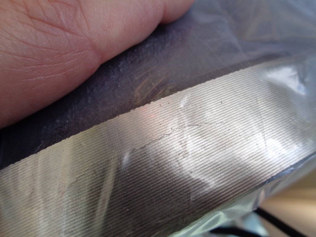

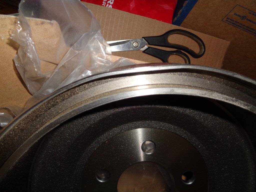

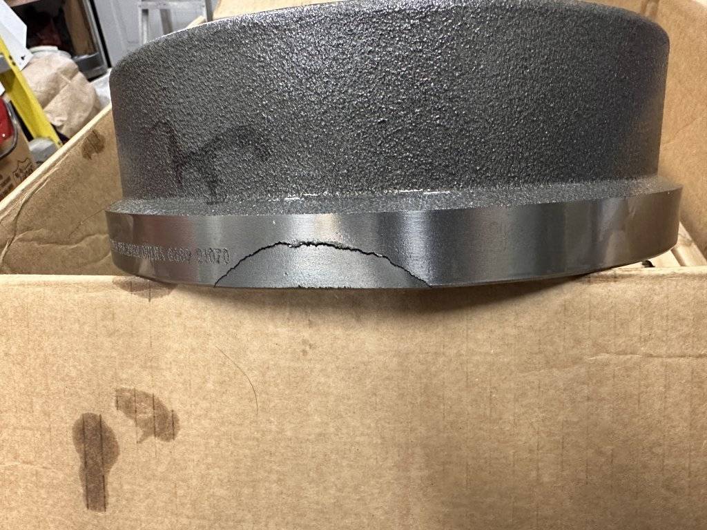

Its actually cracked. I think someone got it cracked before me and sent it back. now I got it
Somewhere along the line, the drum got dropped hard. Contact RA to return it as it is damaged. Any damage on the box?

no damage. It was in the box but the plastic bag was scrunched up in a ball under the drum. Someone had it before me, took it out of the plastic, seen it was damaged and returned it.
Now I got it and if I send it back they dont refund my shipping cost. I'll have to do a charge back on Visa
Also this is a painted drum....1924R is bare. What a pain in the ***. I ordered this to be on the car this weekend to meet up with friends from out of town.
I'm gonna put it on anyway and see if I still have issues. I ordered another 1924R today. I just love giving away money

DON'T PUT THAT PAPERWEIGHT ON ANY CAR! You can SEE HOW BADLY WARPED it is. That drum will destroy any pair of shoes you put with it man! If you INSTALL that thing, you'll LOSE ANY RETURN RIGHTS YOU HAVE!
Scream at Cock Auto about this atrocity, get your $ back, and find another brake drum, even an OLD ONE, rather than this SEVERELY DAMAGED ONE. AGAIN, DO NOT INSTALL THAT DRUM!
Even drums which have been warehoused with the box on its edge, standing up, can have slight out-of-round ness. Usually, that can be lathed out. What you have is much worse.
What happened to the orig drum? Just curious.

Since a 1924R Chineseum drum is a 1965 - 1970 Light Duty " C " Body 11 " x 2 3/4 " Brake Drum --- made by one Chineseum outfit --- and sold by each and every internet outfit --- all your raybestos, centric, bendix., Delco outfits packaging and hawking chineseum brake drums --- you will get that same molded piece ( no balancing , no weights --- like the beautiful picture you got fooled into believing you were getting.....) from all of them....
I have one pair of *** N.O.S. *** U.S.A. made *** C 1924 Century Brake Drums ( Century has been " OOB " (Out of Business ) since 1990 , formerly, of Saint Louis, Missouri , and that is where Raybestos " stole " the part number ,

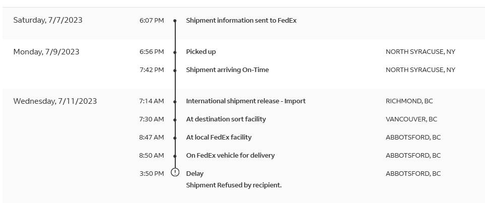

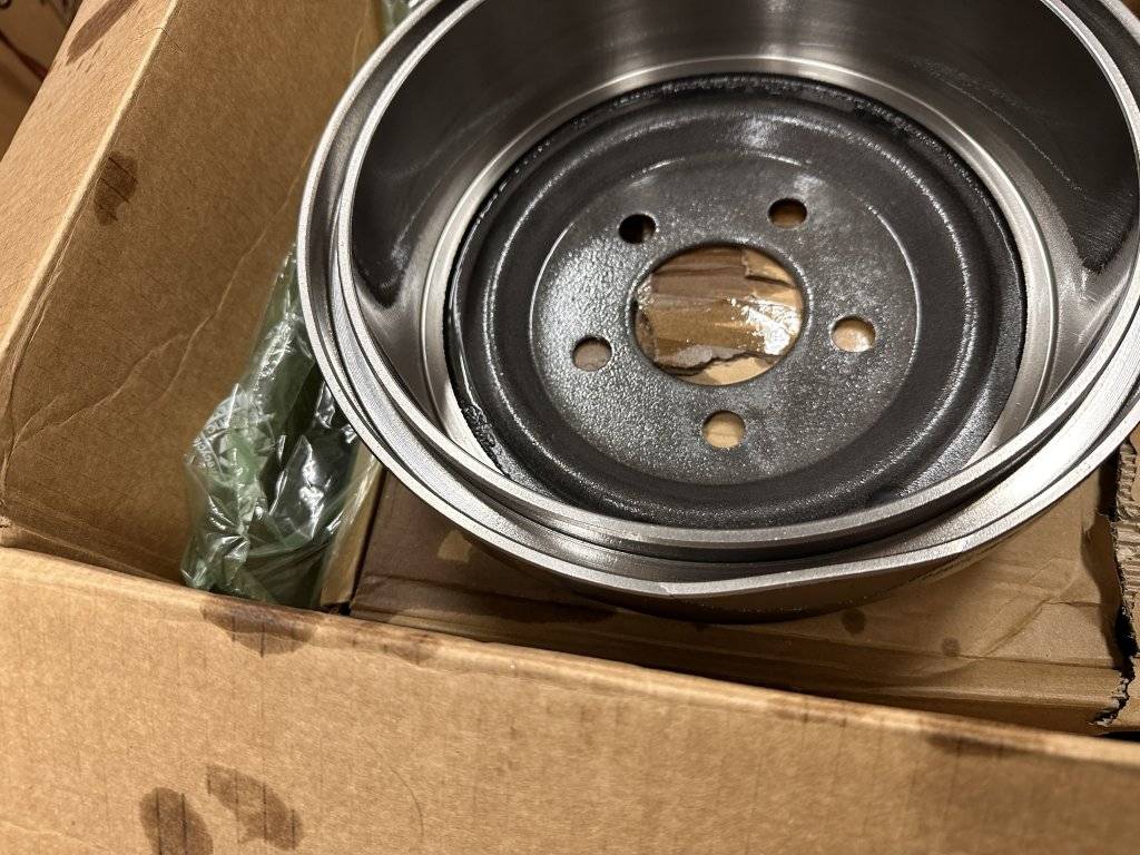

Well this drum came today and I refused it. I hope thats the right thing to do. It was dented and cracked, no paint or weight on this one.
Bag was sealed unlike the previous
FEDEX left with it
You did the right thing, refusing damaged merchandise. I suspect the FedEX operative took pictures of it with his terminal, for documentation?
RA's shipper probably has more drums just like the one you got, very possibly.
