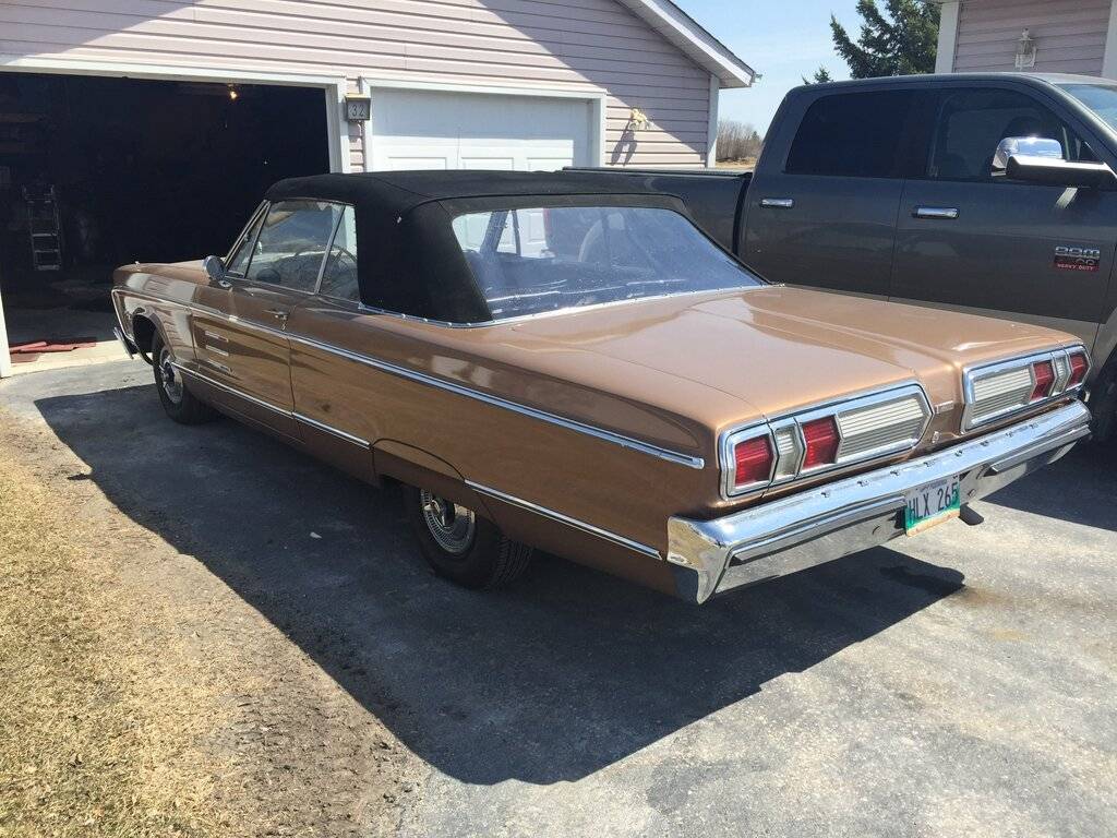

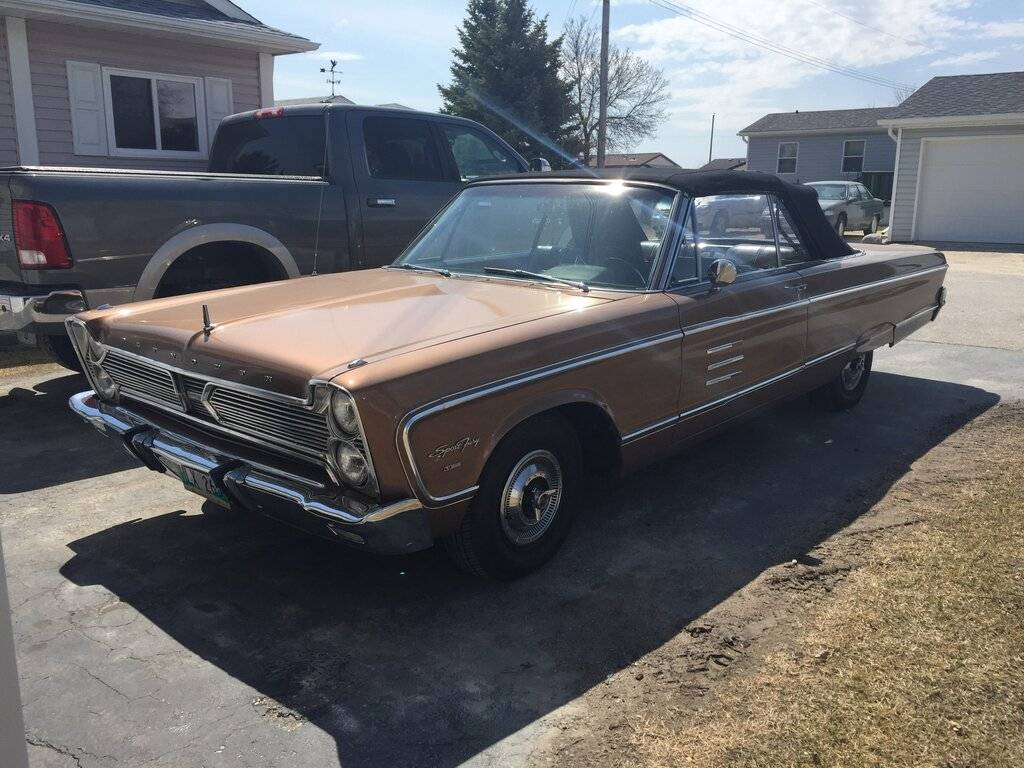

As mentioned earlier, make sure that the frame is good and properly aligned
Mine was not and it shows
