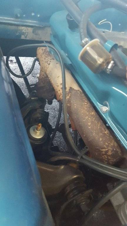

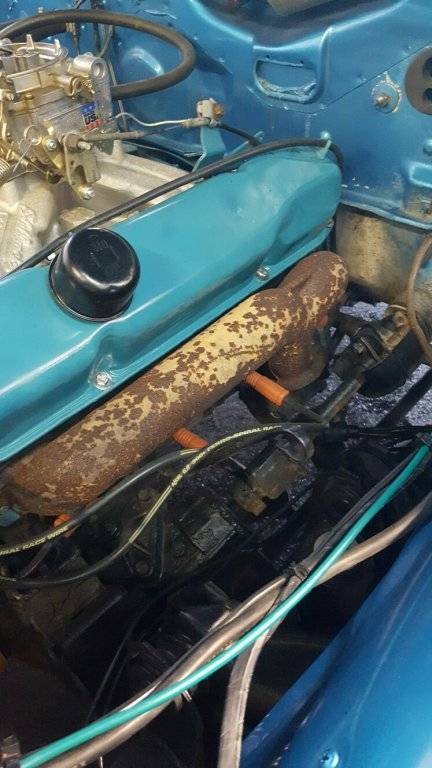

As the date approaches to pick up the built 440 for my '65 Fury, I'm trying to gather the parts that I'll need.
Since the 440 will want to breathe, I want to put headers on it. I can get them from TTI, but they will set me back almost $800 in plain uncoated steel.
I've seen several posts saying that the stock Mopar hi-po exhaust manifolds are fairly good performers. I've included 2 pics of the manifolds on 383 that's in the car (original engine, I do believe).
Are these the hi-po manifolds? If yes, I will probably use them. If not, looks like I have to open the wallet...
Unless, of course, someone reading this thread has a pair kicking around that they'd consider parting with.
Thanks...
Chris

They're identical to my own, on my 383 w a 2 bbl Stromberg WWC. If you ever want to sell the 383, drop me a line.

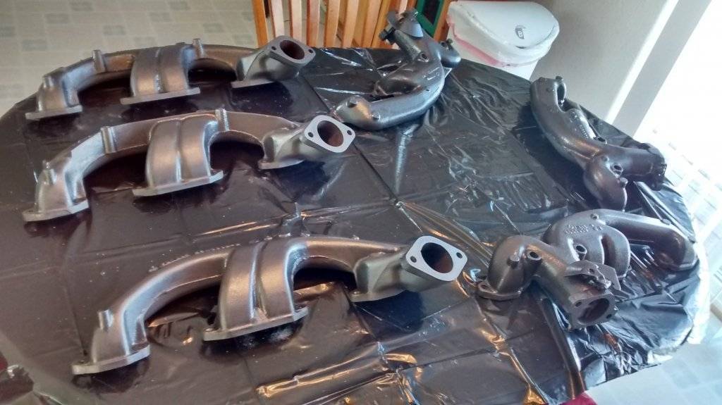

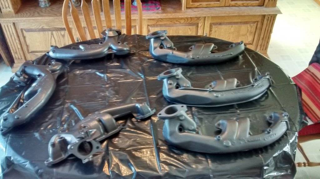

Yes, stock manifolds, and HP motors are not painted blue either.
I'm with Gerald on that 383; if you want to sell....
They are the Two barrel variety.
I had those on my 65 Sport Fury and all I can say is that they were terrible manifolds. At least go with the HP manifolds shown in one of the posted replies. those log style manifolds are not worth anything. I have a set of Schumacher shorties and they are great but I am stepping up to the TTI full length ones as I am also adding an 8-71 supercharger.
