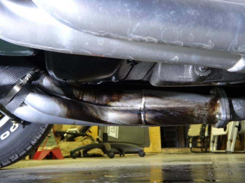

Then, making the last left turn for home there was a terrible bang bang bang sound coming from the rear end as I rounded the corner. I had noticed a slight sound like that one time before but not as severe. Then, on top of all that we got home and looking underneath noticed the right side exhaust header covered in oil at the bottom around the collector, with the source coming from the corner of the bell housing inspection cover.
So Willis is off the road. Pulling the gas tank to fix it right, check the rear diff for something broken or the sure grip not releasing on a left turn, and repairing what is likely to be a leaking rear main seal. Aarrrgh #@!(!&*&_

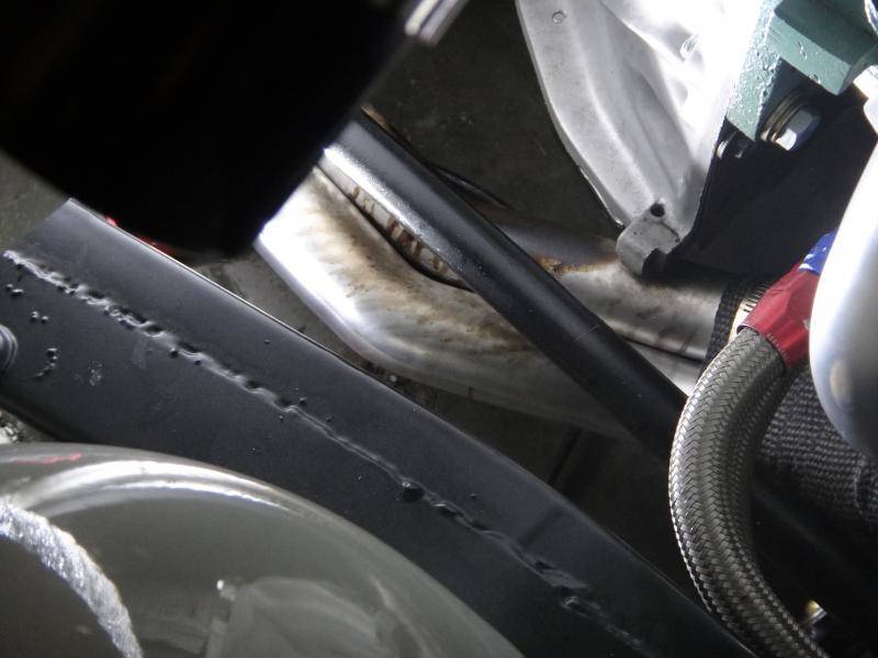

Keep looking "up" for the oil leak. Looks like you have a relocation kit there. That volume of oil is not a rear main. If it was, the clutch would be slipping by now too...

Good point, however I had a go around with the relocation plate the first time I turned the engine over and oil pressure came up. Leaked like crazy. Ended up having to chamfer out the inside of the plate a bit since it was rocking ever so slightly on the block and not allowing the outer oring to seat. Pretty sure that's not the issue this time since the source is the bell housing inspection plate.
Leaning toward a pan gasket but it's going on the hoist tomorrow so I'll update when I know more.

Up front leak, what I thought was a rear main seal or pan gasket was actually a front transmission seal leaking into the bell housing. Fortunately the wind from the flywheel pushed the oil out the bottom an the clutch wasn't affected. Next endeavor will be pulling the tranny to fix that. Its an A833 4 speed that was completely rebuilt, but sat for 2 years waiting for the car to finish so the seal likely dried out.
