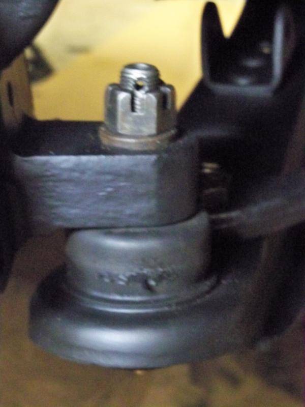

Dec 31, 2012 #1 jake Senior Member Joined Oct 23, 2012 Messages 1,537 Reaction score 1,079 Location wisconsin Castle nut on my ball joint is lower than my pin hole and i have not even torqued it to specs yet. New frontend kit from pst, any suggestions
Dec 31, 2012 #2 polara71 Old Man with a Hat FCBO Gold Member Joined Nov 16, 2010 Messages 44,759 Reaction score 24,555 Location Idahoan displaced taller nut or add another washer.
Dec 31, 2012 #3 commando1 Old Man with a Hat Joined Mar 10, 2011 Messages 37,382 Reaction score 38,548 Location Sebring, Florida polara71 said: taller nut or add another washer. Click to expand... Sounds right. (Sent using Forum Runner)

Jan 16, 2013 #6 Husky Member Joined Sep 27, 2012 Messages 89 Reaction score 8 Location Sydney, Au That stud looks too long. What brand of ball joint is it?
