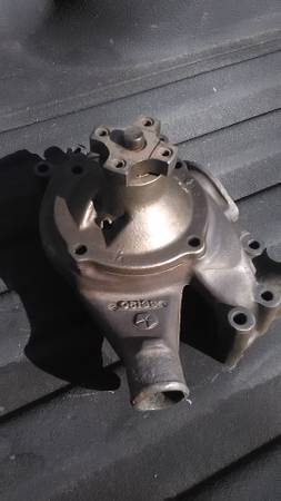

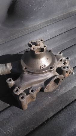

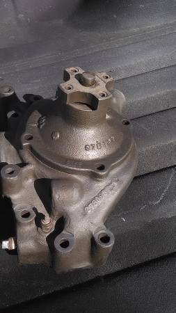

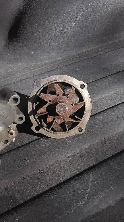

Here is the lovely pump I scored today. The fellow who sold it is quite a gentleman too. He scoured this thing clean w hydrochloric acid to give it the nice clean iron look you can see in the pics I cribbed from his Craig's list ad. Note how there is no breakable flange for the thermostat housing on this particular model. That was what motivated my original search for the aluminum housing I wound up purchasing cheap on eBay and trying. My old housing had cracked at the thermostat flange due to the former owner over tightening the bolts due to his negligence in removing the gasket! I got this beauty for less than I gave for the sino-rubbish I've used the past year. Mind you, at FIRST, and for last summer, it SEEMED OK, w Tilly only running about 5 degrees warmer. I dismissed that as statistical noise then, but with this early spring and her already running up to 210 occasionally, I got alarmed. I'll install the housing and keep the Gates pump I got last year unless I see something grossly amiss with it, then get the new radiator. If that doesn't cool Tilly down I'll have to dig into the block itself. Compression was between 125-160 psi on her cylinders last Fall, so I'm not apt to believe that the head gaskets have any leaks, yet..... Of course, the bell curve shape of the compression readings with the front and back ones low and the middle cylinders high indicates there has indeed been a good bit of wear and aging. I reckon I should just rob a bank or something maybe.....
What did that hydrochloric acid do to the seals on that pump? There's a spring and a carbon seal in there, I believe, and maybe also a standard lip-seal to seal it externally?
Toss the pump. Acid will have intruded into the bearings thru the seals and the bearing will fail in short order. Never use acid of any type on any Mopar cooling system! The housing is probably ok. Coolant going acidic is why things rust up and fail to begin with, more of the same is not going to help as acid will continue to degrade the iron and bearings long after it has been drained out.
Dave

Good advice. I DIDN'T plan to use the pump. Just the housing. My Gates pump is doing very nicely w the new radiator. These Gates look pretty close to the heavy duty w-AC Mopar pumps of yesteryear. Thanx all the same Dave. My next cooling project will be to make a good custom shroud. Summit Racing sells a kit that looks MOST promising. It occurred to me putting a pusher electric fan in front of the radiator might alleviate heat in stalled traffic too, but its NOT an efficient solution, while directing airflow properly is!
