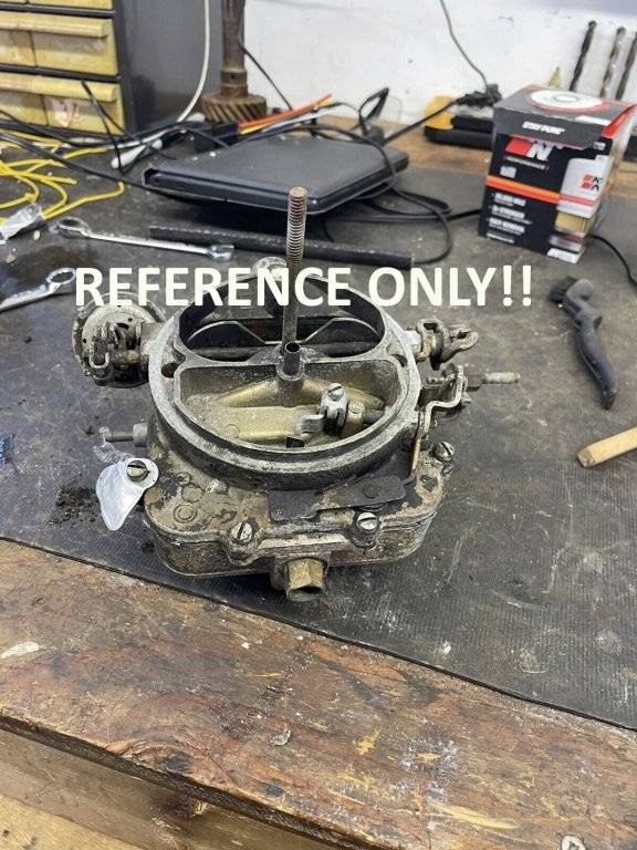

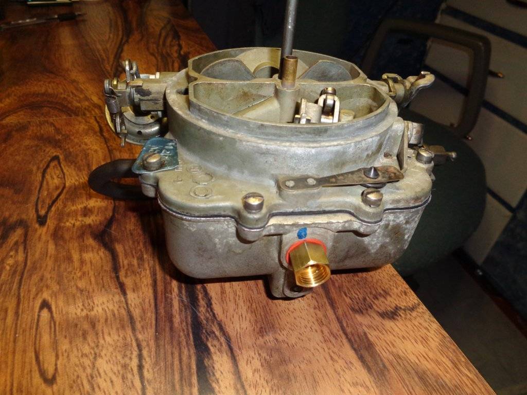

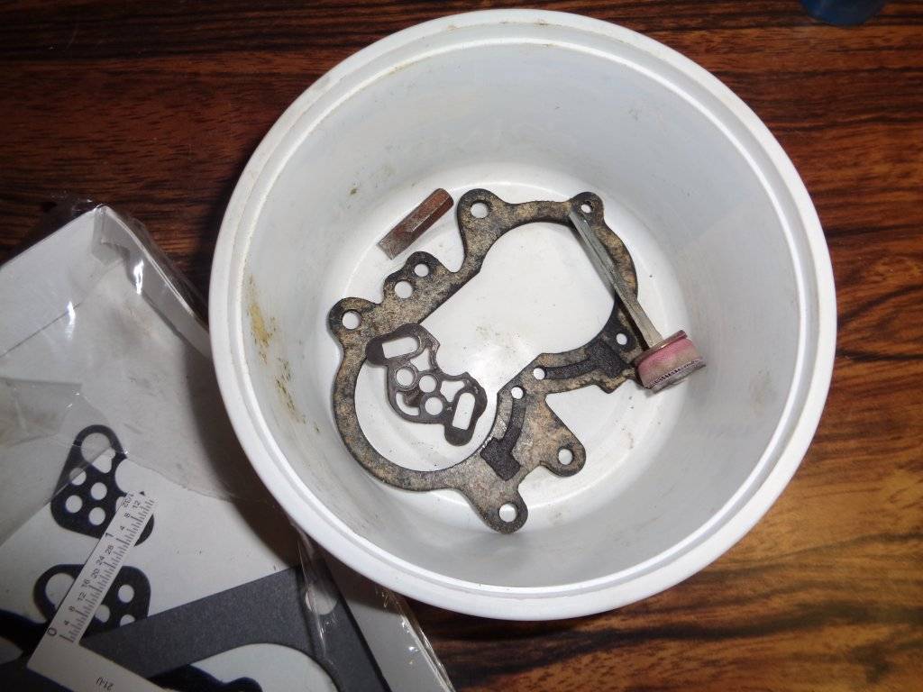

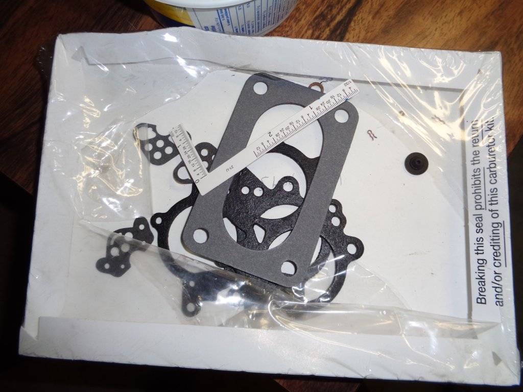

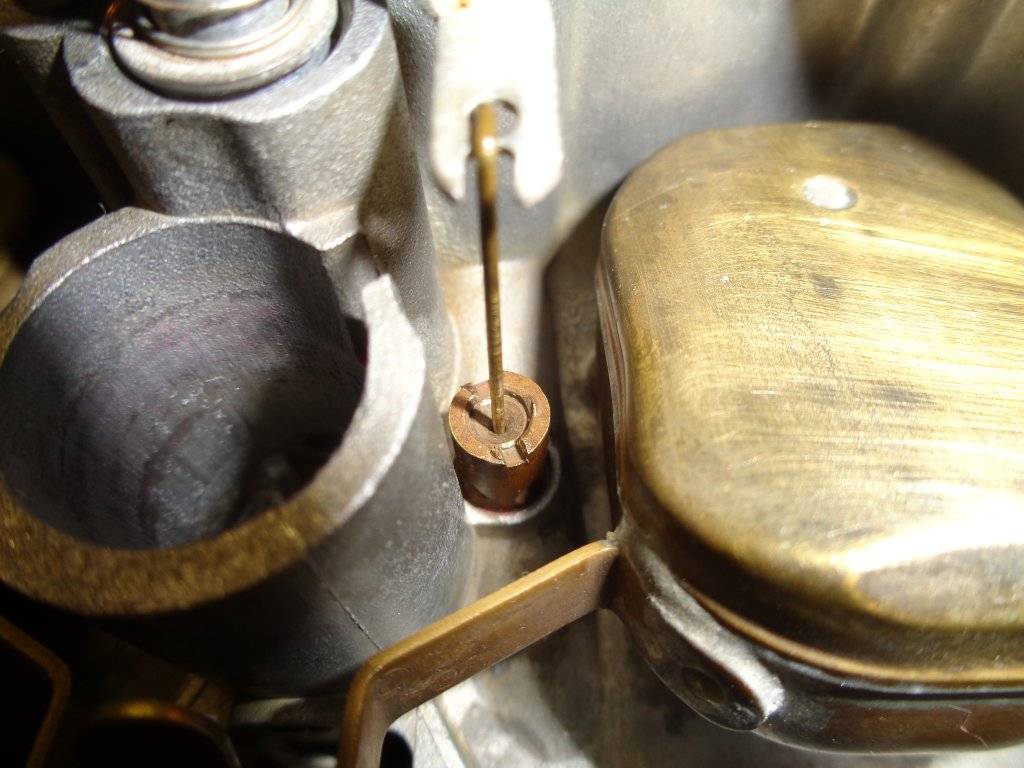

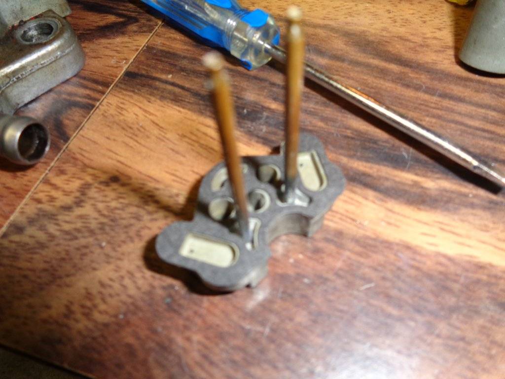

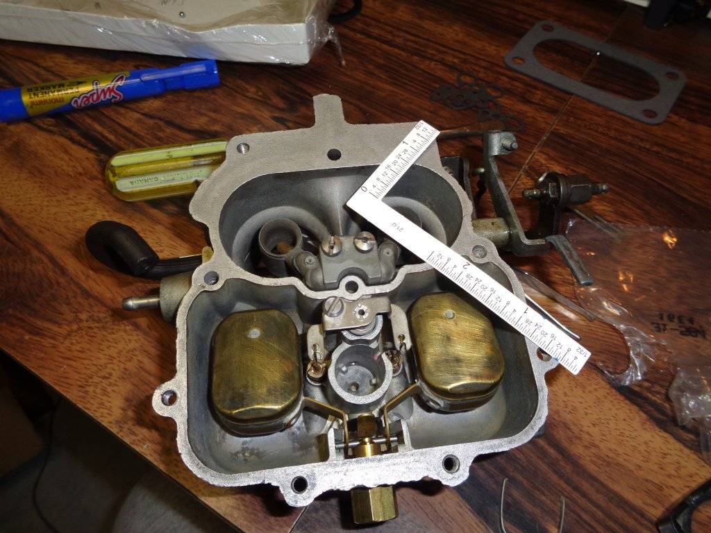

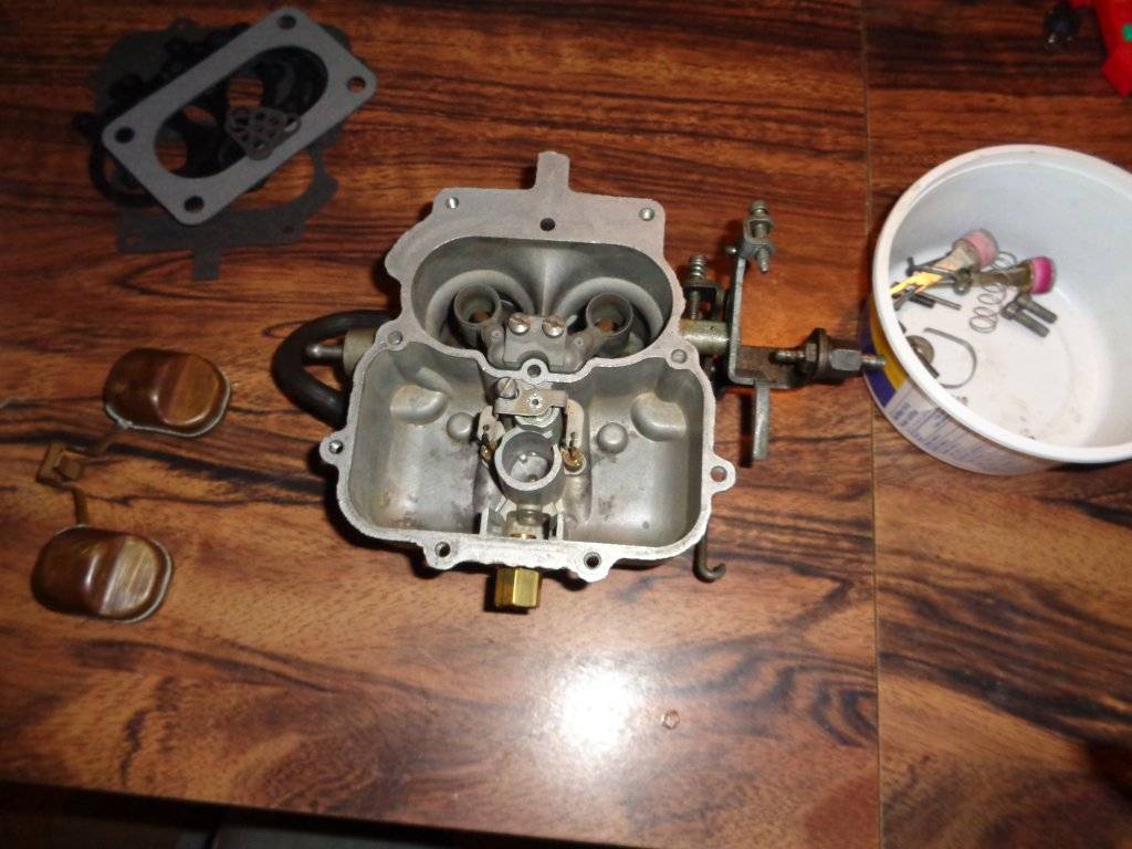

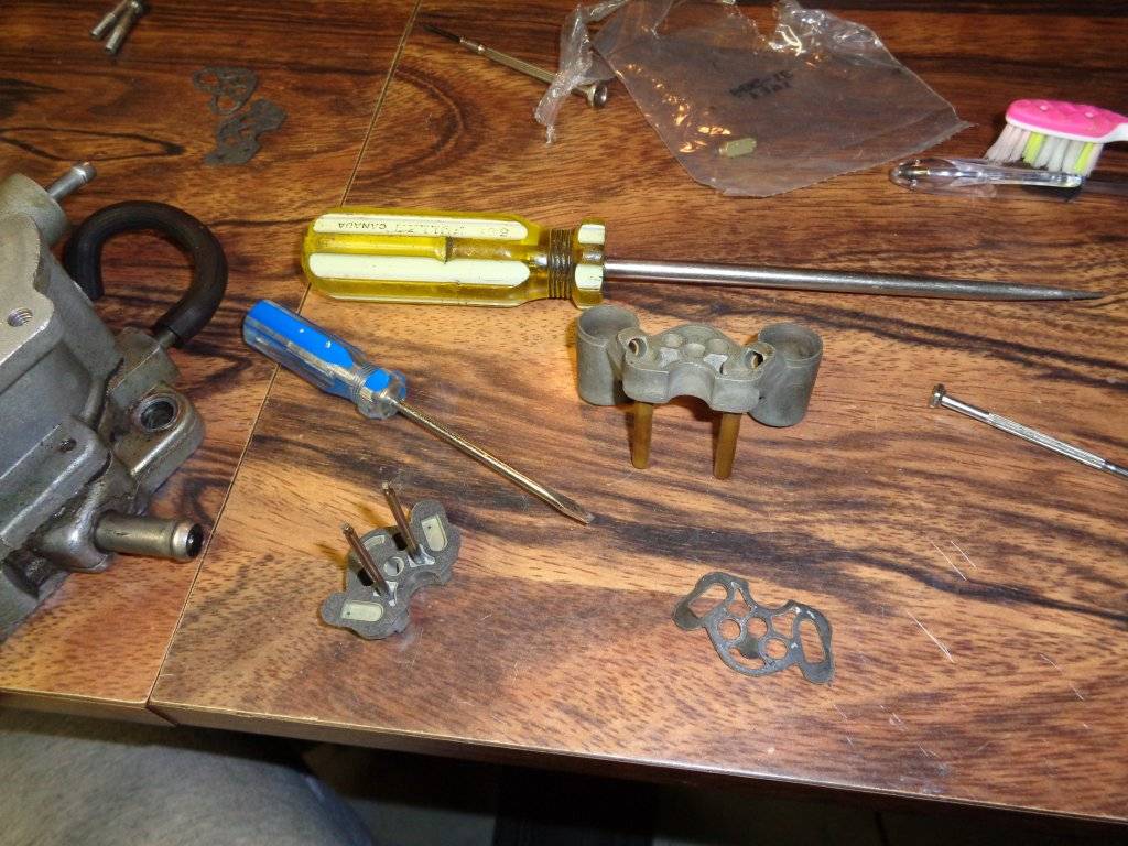

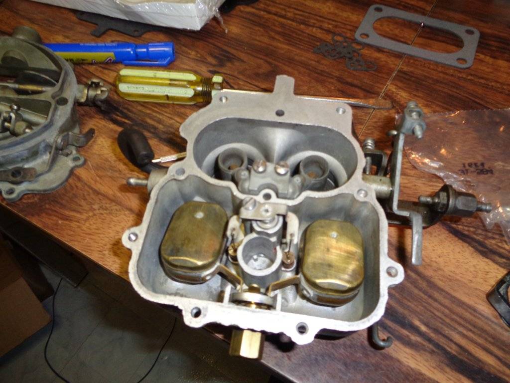

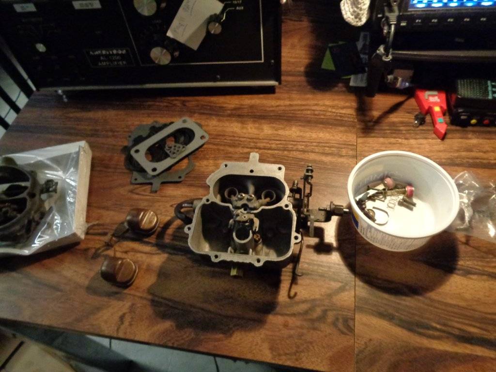

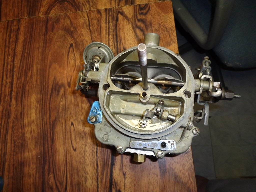

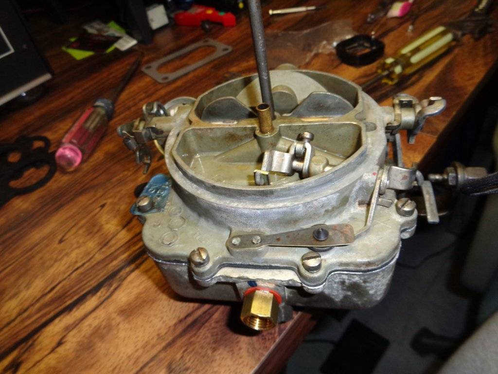

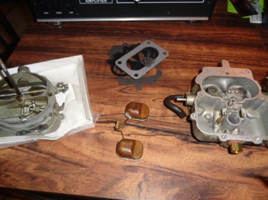

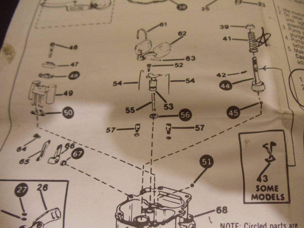

I am rebuilding this and the kit has 2 reddish round gaskets, 2 bigger black rubber round gaskets and a round cork gasket.
Not sure where they go. Any one know please? thank you

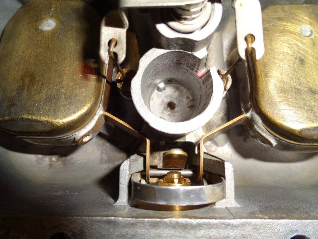

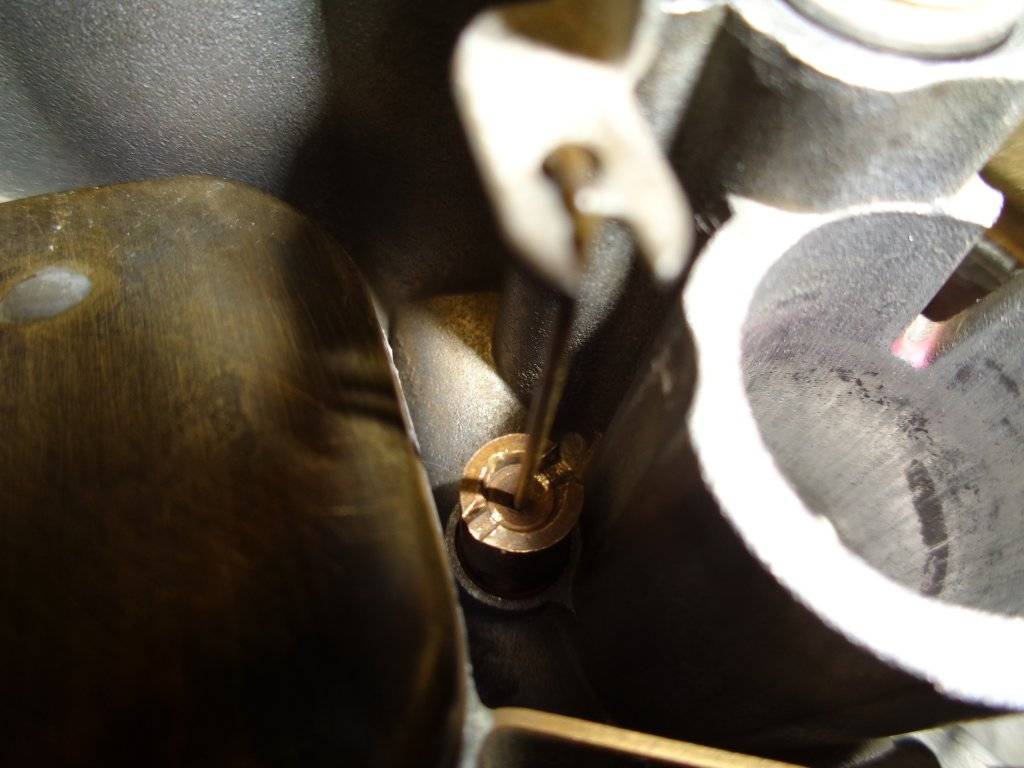

the red ones must be optional "57" jet gaskets, mine had none and the black must be metering piston spacers "56".

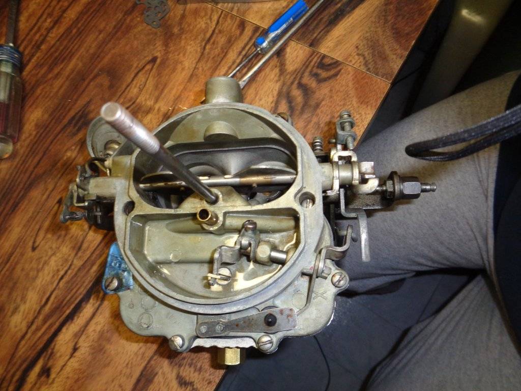

Well I rebuilt it and the car runs so much better with a accelerator pump.

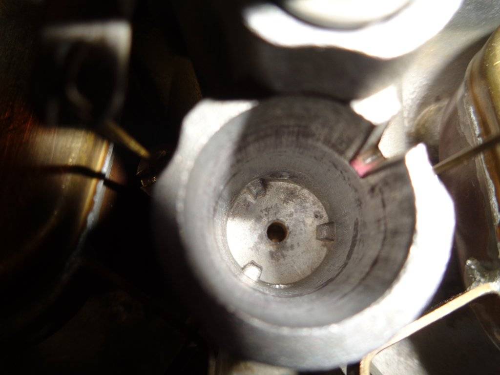

I did scotch brite the power piston but in hindsight, I should have did the bore and the pump bore. I can always work on it later.

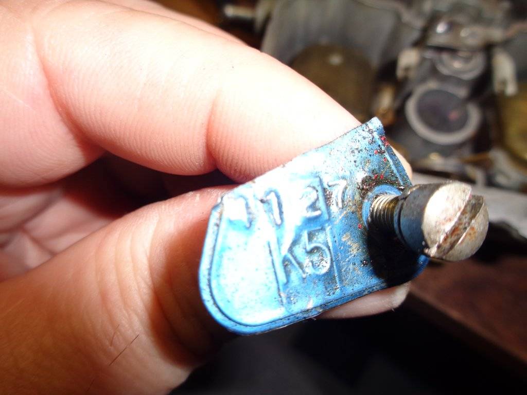

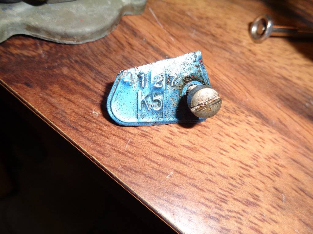

I did use the red gaskets on the jets and the black rubber on the piston. I dont feel good about it though. how knows. they say "late" models ditched them. mines a 66 4127S
