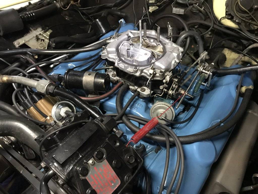

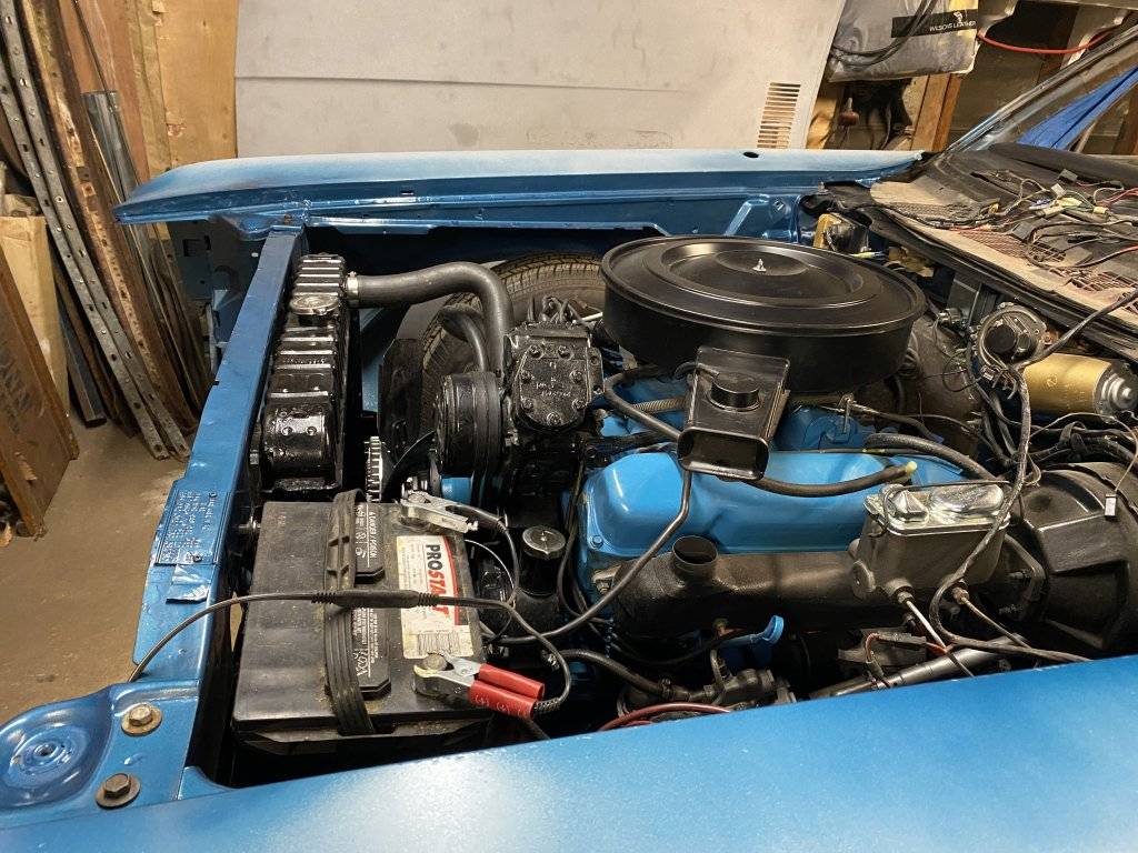

Surprised to hear that Hirsh paint didn't work out for some.... I don't care about paint on rubber, paint on iron is what really matters to me.
POR-15 engine paint is good, they offer it in brush on form though, unless they've come out with sprays recently. After I used that on one engine, someone mentioned that Hirsch is better. (?)
I've had fair results from Dupli-colour in the past - the only down side is that it goes on very thin and adhesion is not that good. Durability over the long term not so good.
My machinist gets me Aervoe Engine Enamel which I have found to be superb, they have Chrysler Blue, and I highly recommend. You have to get it through a supplier, though.
I've never heard of Aervoe brand paint, I'll look into it. Thanks to you and SAMPLINGMAN for including photo's.
