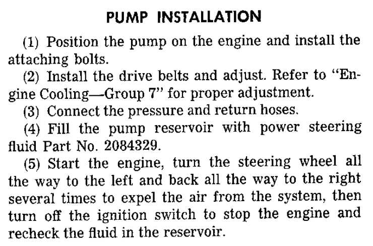

    Did you bleed the system with the front end jacked up per the service manual? Jacked up with the motor running, one full turn to the left and one full turn to the right. The manual doesn't instruct to jack the front end up but I've felt it is easier to turn if the wheels are barely off the ground.
