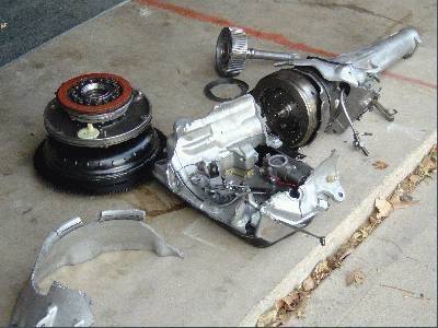

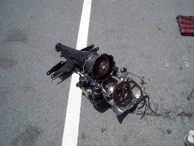

had a spag pop out , an cough'd the motor . shear's rod bolts n sent two rods n pistons lose . it stopped turning of course . and a bunch of parts later (block , head , rods , crank , cam ) . back to the track , oh and a bolt in spag in that trans .

I have never seen the tail shaft housing come apart like that, crack in half, yes. Whole pieces of the front side come out from under the car and chase people away from the starting line.

My buddy read through the thread and thinks that without being able to inspect the remains that the output shaft simply failed. It isn't common but does happen and he said that the age and weight of the vehicle could have caused it. That being said his is just an opinion from the evidence in this thread. He also would rule out the universals for the lack of symptoms.
The sprag failure that I've seen is mostly to the main case and parts grenading thru the tunnel, so I'm not sold on that being the cause. Odd the tail shaft housing is destroyed here.

When was the last time you checked the txsm fluid level? Jeff brought up a good point where the case appears to have been cracked for a long time. The txsm fluid could of leaked out and lack of lube and extreme heat buildup could of grenaded the txsm.
If it was even a quart low it wouldnt have moved.... Since they all leak due to age and lack of miles fluid was topped off every time theyre used

I gotta believe the output shaft failed. Question is why. I would plan to look at the rear end, and I'd expect the transmission to have big damage inside to. Without the tailhousing bushing the front section only has the rear support and the input shaft. I'd imagine there's problems inside the case now too.
