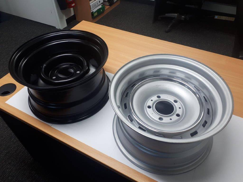

It's interesting that both shops use banding. Brad said banding is outdated and too hard to perform. Brad said that shops now reuse the centers and replace the entire rim shell. I guess not everyone agrees.
I think the new rim-shell is a little more robust also. My wheelcovers don’t travel or come loose as they did on the original wheels with radials mounted on them.
New rim shells is how Brad widened the C-Body Road Wheels that I sent to him, and the OEM police wheels purchased from him:
