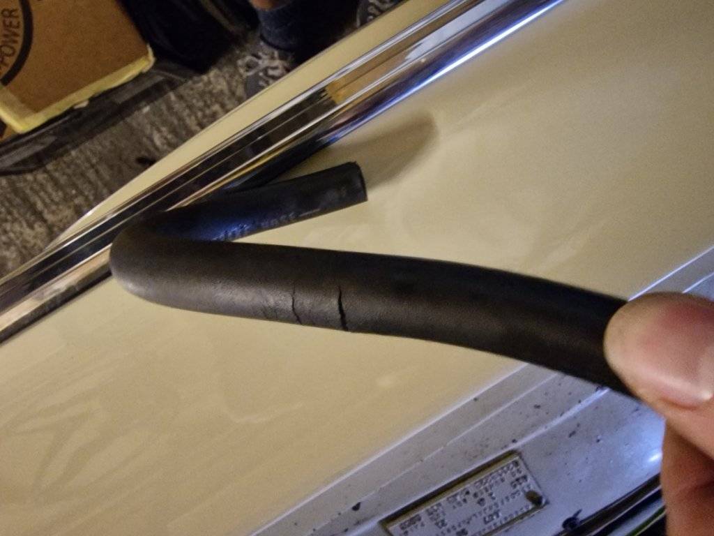

Hi again
Further investigation today and found the vacuum hose looked OK in its position but on removal I found several cracks allowing air in ,I have a new 11/32 hose arriving tomorrow will let you know my findings on replacement.
