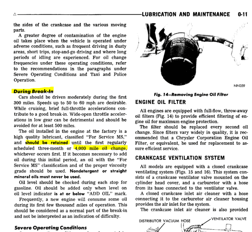

Below you'll see a snip from the 1970 Chrysler FSM, and this same wording goes back another five years based on a quick check of other FSMs. It's clear that this oil was not a break-in brew at all, but just regular motor oil. Possibly it had a few ounces of moly or other slippery stuff added at assembly.
So, fast forward through 55+ years of science, technology, and lubricant magic and the 2020 Vette adds a mere 3500 miles to Chrysler's recommendation. So much for the 500 mile myth, unless you're using true break-in oil that DOES need to come out sooner than later.

Interesting for sure . If my car I would still change it, maybe not at 500 miles but well before the recommended time. Especially for the first time while breaking in.

Below you'll see a snip from the 1970 Chrysler FSM, and this same wording goes back another five years based on a quick check of other FSMs. It's clear that this oil was not a break-in brew at all, but just regular motor oil. Possibly it had a few ounces of moly or other slippery stuff added at assembly.View attachment 393637

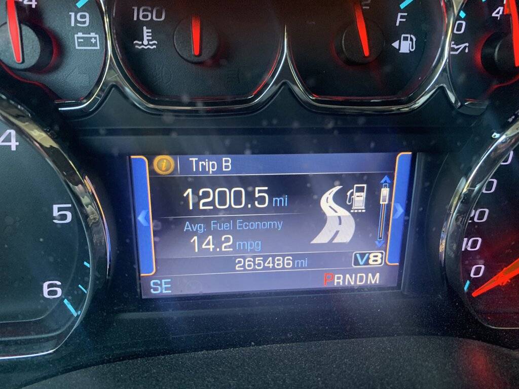

Typed while sitting in my 265k+ mile 2014 Chevy work truck. Original engine.
Take that Japan!!!
