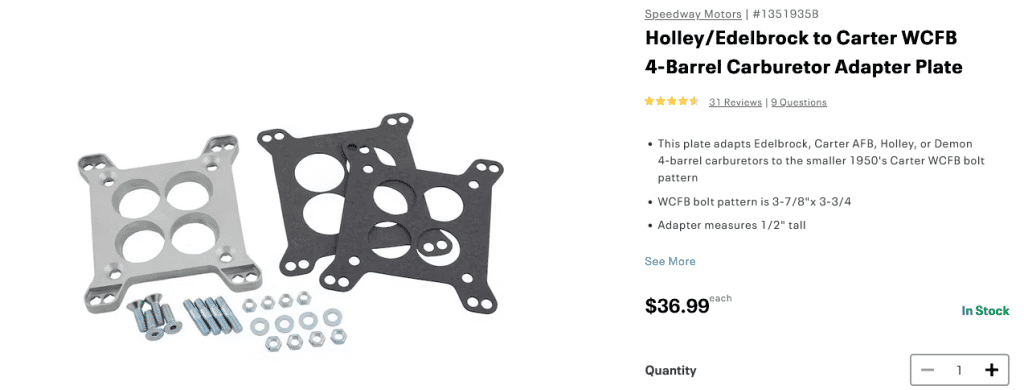

what bolt pattern would he need? i see that speedway has this oddball to adapt to the old small wcfb pattern. Holley/Edelbrock to Carter WCFB 4-Barrel Carburetor Adapter Plate

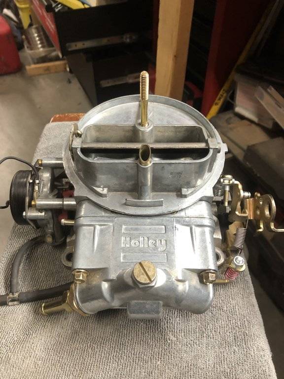

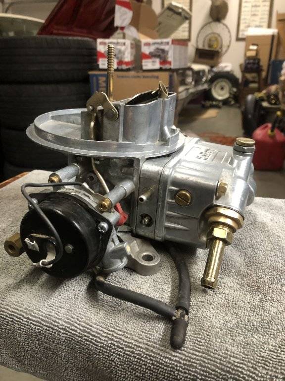

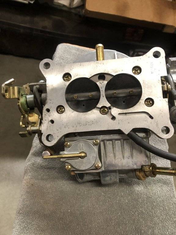

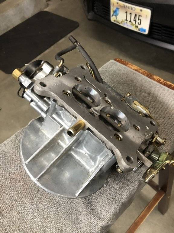

Agreed ! I have a like new Holley 500 2 bbl I will send you fo 50$ + shipping .
The 2 barrel is a model 2300 and is 500 cfm.

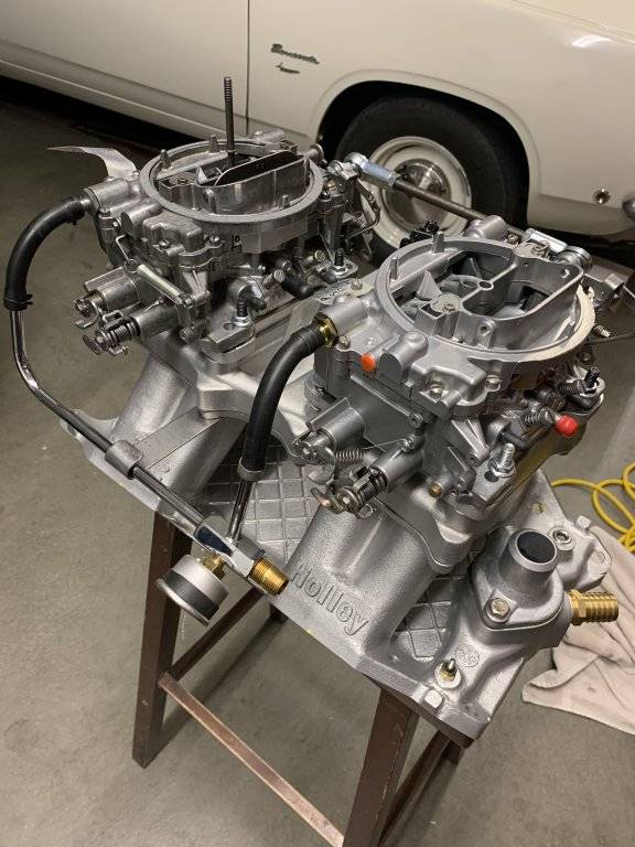

Here is a pic of linkage I made for a pair of Eddie 1405s on a W2 Pro Dominator tunnel ram .
