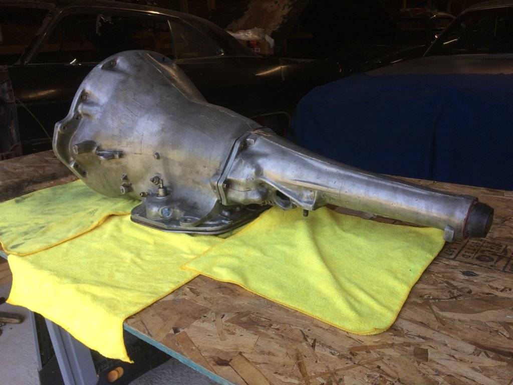

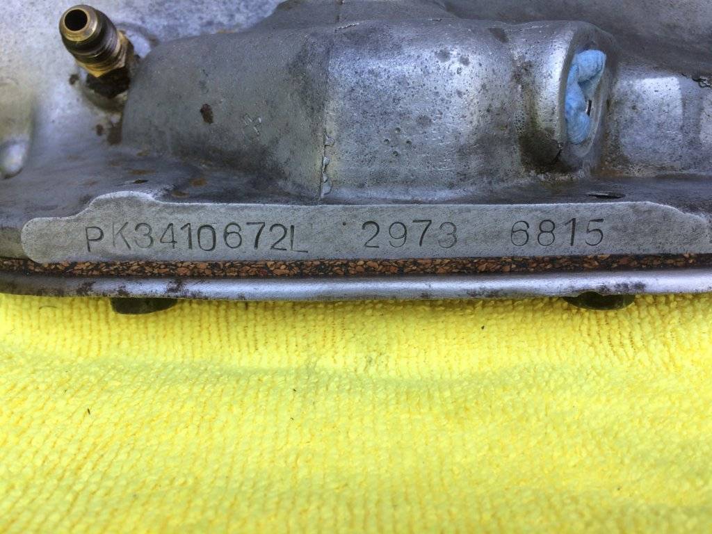

Fresh rebuild of correct #672-6BBL Torque-Flight to factory 6BBL specs. Slight upgrades to clutch pack and friction discs.
Transmission likely is a warrenty replacement 6BBL transmission from a 6BBL Sport Fury GT. (Based on dated C-body specific tail shaft) The #672 is date coded and part number correct for The Black Car! Will detail cases before installing.
rare trans!.. whats different on the tail housings?..never compared any!
Hey Dan,....yep,.. really rare Torque-Flight, the best part is the assembly date!
The difference in the tail shaft is small, simple but meaningful. It's the transmission mounting point. A C-body 727 tail shaft has 5/8" studs for the mount, whereas an A,B, or E-Body uses bolts, so the "mounting holes" would be empty on an A, B, or E-Body. Different cars, different mounts, different production methods. It's in the parts book/catalog etc. So,... C-Body 727 tail shafts have studs for the transmission mount. Who knew? I had no idea until my trans builder mentioned I had the correct C-Body tail shaft. I confirmed this with other MoPar transmission experts.
Cool part of the hobby,.....learning about small details from other folks!
The main case casting date and the tail shaft casting dates are the same month, so it's possible that my #672 6BBL 727, was a warranty replacement for a 6BBL GT, as there is no VIN stamp on the VIN pad.
It's a total "home run" for the car........now I just have to find the numbers engine.
The 6BBL transmission came from Georgia by the way.....

How did you end up finding such a rare trans? How does one even search for that? Hell, it took me a few years just to find a 489 w/ sure grip that was in good condition, and I wasn't limited by date numbers.
Are the studs pressed in or threaded? I can't remember what my replacement trans had, but it bolted right in, so I must have lucked out and got a C-body tail shaft.
Legend has it the #'s motor still exists....is that still the accepted truth? That would be amazing if you could find the motor.....your car would be just "that" much better with it. But even if you don't I personally could care less.:thumbsup:
Good info!
The studs are threaded on a C-Body tail shaft.
How did I find it? Searching for 1,479 days. Every day.....
In those 1,479 days I found 3 correct #672 6BBL transmissions, but the date codes were not correct, so I passed on them.
I was very fortunate to find this 6BBL-727. It’s 100% correct for the car in every way, and it’s possible it may have been from my car originally.
It’s hard to find dated and correct parts, so I know your pain.
