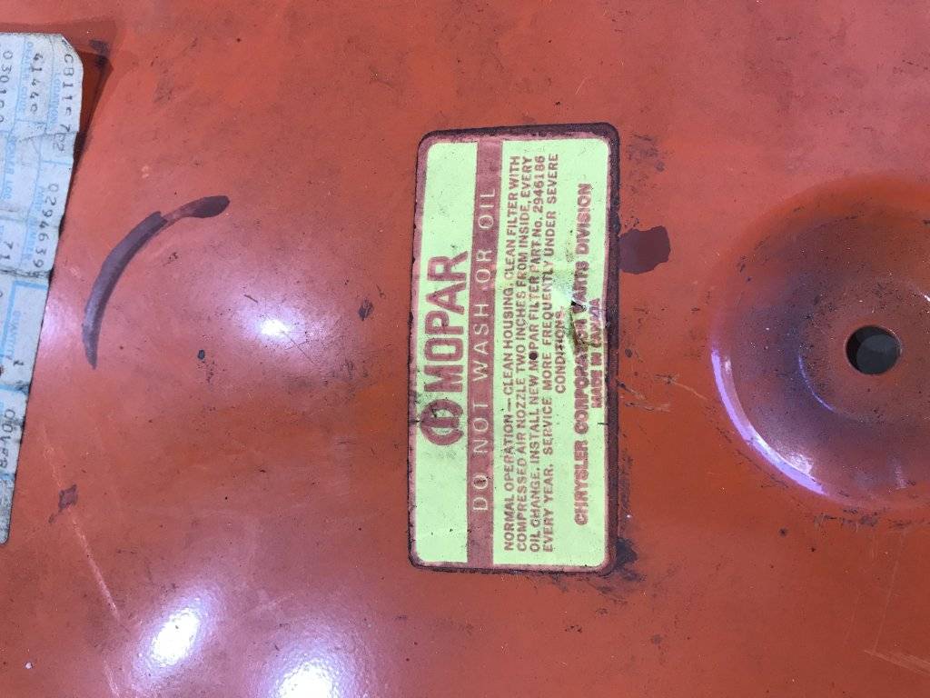

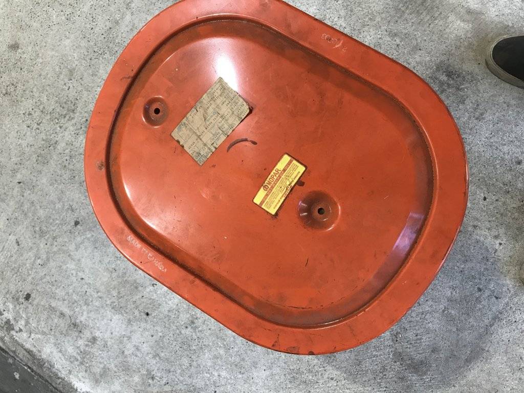

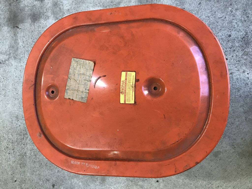

Just scored this today…
Original 6BBL air cleaner lid/top….original paint, decal, 100% NOS…..
Baby steps….& more “happy dancing”!

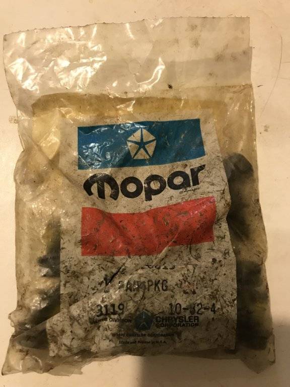

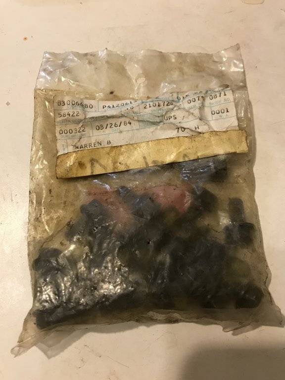

NOS oil sump fasteners for the baffled oil pan & NOS rocker cover grommets, for PCV and vent tube cap…baby steps…:)

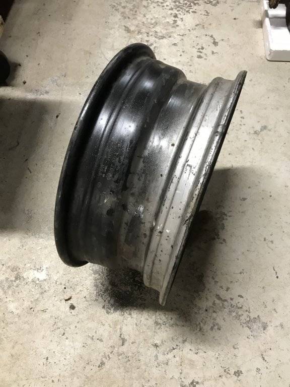

NOS painted Road Wheel. I got this for paint sampling and matching the correct color.

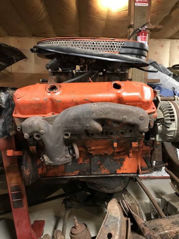

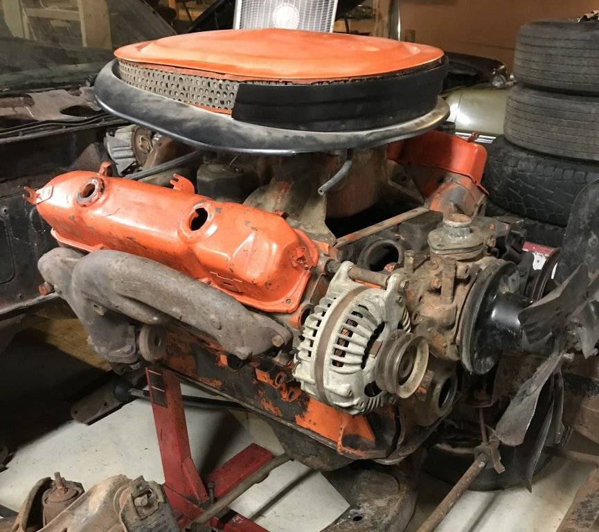

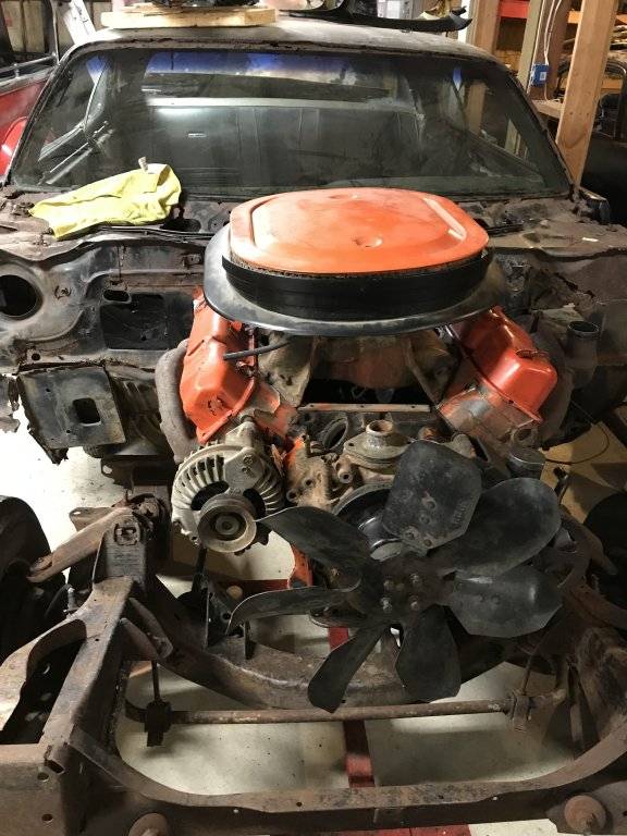

An original survivor 440 6BBL GT engine, this is a quick mock up just for fun. I’ll put more correct parts on it soon.

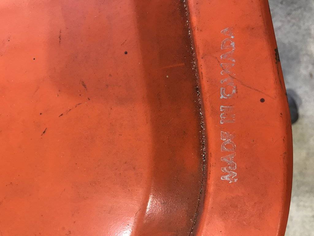

Try some gentle paint cleaner/polish to bring up the finish without loosing the lettering. That made in Canada stamp is something I never see on a restoration. My bottom feeder air cleaner looked like yours when I started cleaning it, but no lettering to protect.
