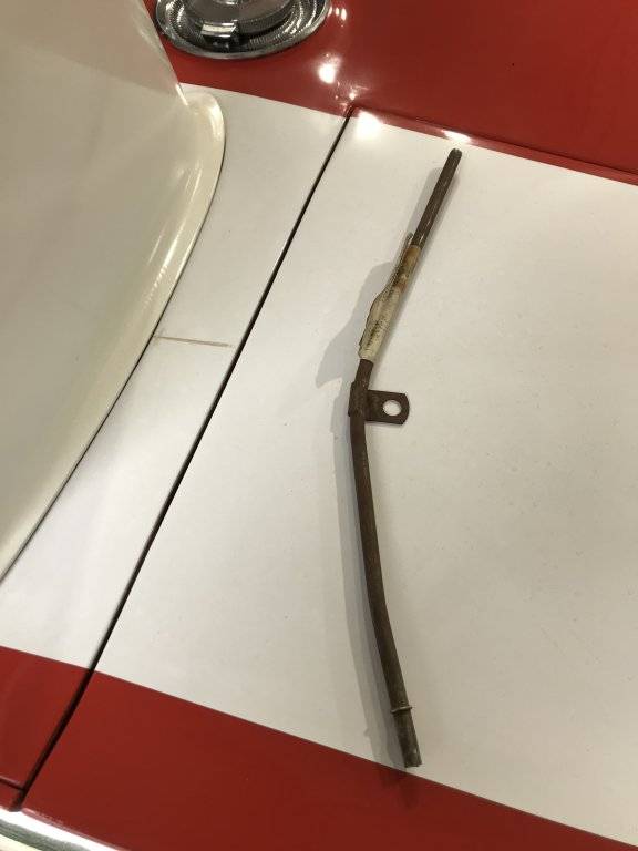

Thanks. I do understand that. But, the pictures he posted of 1970 only dip stick tube was taken on the trunk of a 1969 Dodge Charger Daytona. That's why I was asking.
What exactly is the difference between a '70 tube & other years? And is there a difference between HP & non HP engines?
It was! Good eyes there..the Daytona isn’t mine, but I’ve got dibs on it if it’s available! ;)
Think HP vs standard engines…….
Exhaust manifolds and clearance.
Ahhh, thought it might be that but when I put HPs on my GT I didn't have any clearance issues with the dipstick tube so I assumed they were the same. Gotta love learning something new everyday!
