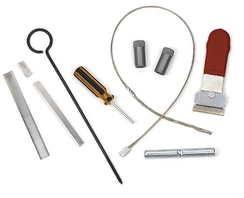

Everything I have read to changing the seal with the engine in car was to do all the necessary steps to get to the point where you can remove the caps and force the crank down a smidge.
Remove the retainer and there is a special tool to push out the top half of the old seal and pull through a new seal.
You WILL need this.
You WILL need this.

what are you using for a rear main? the tools commando showed are for a rope seal, the rubber seals can be rolled in easily. if your using the rope, fit it into the main cap first, then take that piece and pull it into the block by pulling into position with the tool, and you will need to loosen main caps to put in the rope seal. there is a tool to fit the seal to the cap but a large socket will work, tap the seal in place to form it. best of luck
