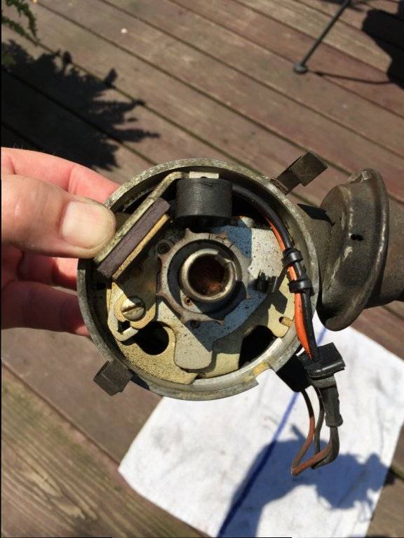

I decided to pull the distributor. Easier to work on the table that way. Look! Here's the little bastard now!!

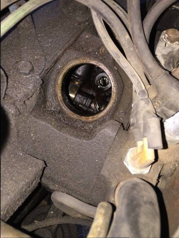

Having the distributor out give me a quick peek at the cam and the gear., not too bad for 92,000 miles., i've certainly seen worse. Disregard all the grunge on the block, i've cleaned it up since I took the picture.

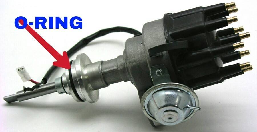

what seal was around that dist base? a flat paper, or a rubber o ring? or nothing?

Looks to be a rubber O ring, guess I should replace that too huh! Good call, I'll get one tomorrow.
