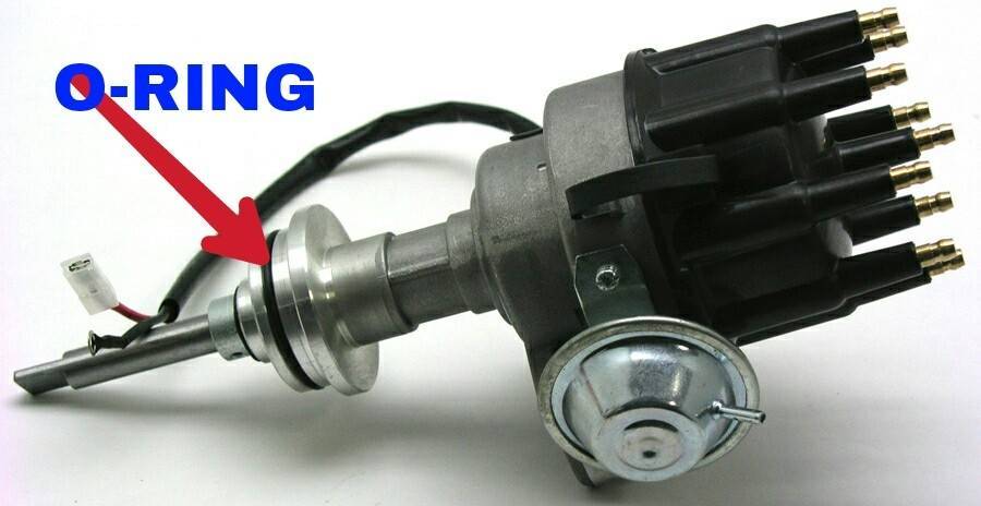

thats cool, but there is another one. i just bought a felpro 1214 valley pan and it came with 3 distributor gaskets - 2 rubber o rings and 1 flat paper.
i was wondering if it is a selection 383/400, or if im supposed to use all 3 provided, or whats up.
- saylor
Felpro, although they make some of the best gaskets on the market, are just like any aftermarket company and will include a number of pieces that are not needed to avoid liability. All you need to replace is the "O" ring on the distributor to seal any oil leaking from there,
