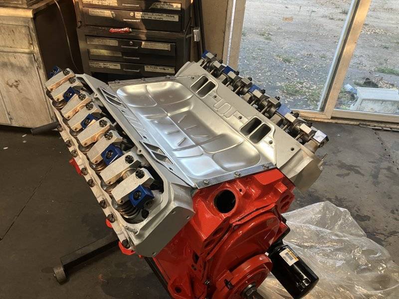

I took the manifold off yesterday. I did try flammable brake clean between the manifold and valley pan and all around but didn’t see an increase in rpm. I wasn’t looking at the o2 gauge while doing this, and I’m not sure what the polling rate is on it to display the value if it would capture a spike or not.
When i took it off i saw i had used paper gaskets behind and on top of the valley pan the last time i installed it but no sealer other than spray copper gasket adhesive at the ports. I could maybe convince myself if i tried hard enough to see at least less of an impression on a couple runners where maybe it was leaking, but nothing obvious. The front and rear hold down bars had oil on the bottom of them, is that normal for oil to seep around the bolts or something? I don’t really see how oil would get around the valley pan at the front and rear.
When i put it back on i used the paper gaskets and some sealer around the ports on all layers. I let it sit hand tight for an hour then torqued it down. I’ll retorque it when i get home today and fire it up and see if there’s an improvement.
If it still exhibits the same behavior I’ll just deal with it until the 440 I’m putting together is ready to put in.

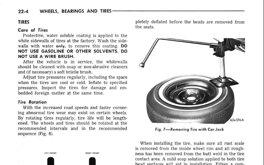

How did you break them down. I did a motorcycle tire recently and it was a royal pain. Just to get it on the rim.
These particular wheels didn't have tires, so I didn't have to break them down.
However... If you take the bumper jack out of your car, you'll see that there's a slight curve in one side of the base. You can use that to break the bead.
Where did I get that you might ask... Right out of the FSM!
I actually have an old jack that I can use with the hitch on my truck.

I’ve never had luck doing this, but i think I’m always to conservative on my boom juice application.
I had a tire service guy tell me how to do this. It's a long story... He told me how to do it over the phone but he was really careful how he worded it that he wasn't suggesting I actually do it...
There's a bunch of videos on YouTube that shows it.
