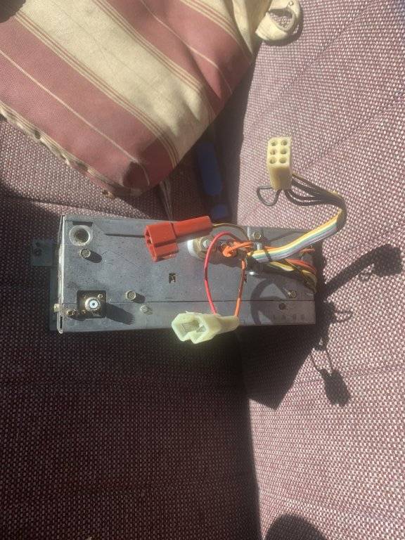

I need the wiring diagram to hook this radio up right, (79-83) I have most of the wires figured out. Looked on line but nothing on the CB type. Thanks

Thanks, Can’t read the diagrams when I expand the page, gets blurry

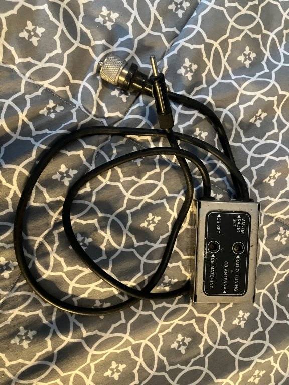

I believe the guts of the CB option are in the radio itself, which means you'll need the appropriate CB-radio antenna for the car. USED to be that power AM/FM/CB antennas (with the mast having the "load" for the CB function in one of the telescoping segments) were available, OEM and aftermarket. Without that appropriate antenna, CB functions will be very compromised functionally.

I am putting this in my 87 Ram, you need s CB antenna and this splitter setup

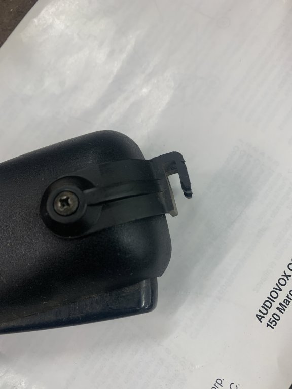

If ? to me, 88 Dodge pickup and yes I have the factory CB antenna. Haven’t found the mic holder yet in my junk.

I may have a spare mic holder if you can't find one, I have a few of these radios.

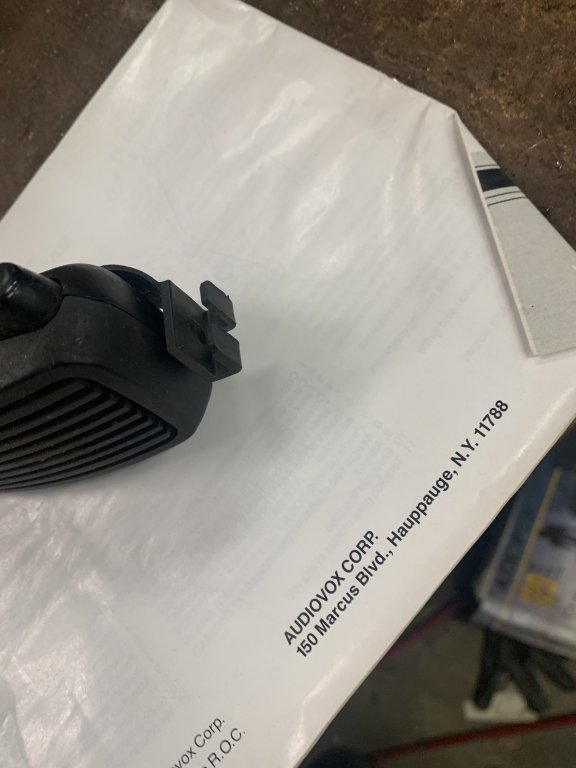

I’m not sure if any part of this works yet, once I get how to hook up I’ll do a bench test antenna and all. I’ll get a pic of the holder on mic
The mic holder and my other CB that going in the Lil Red truck
