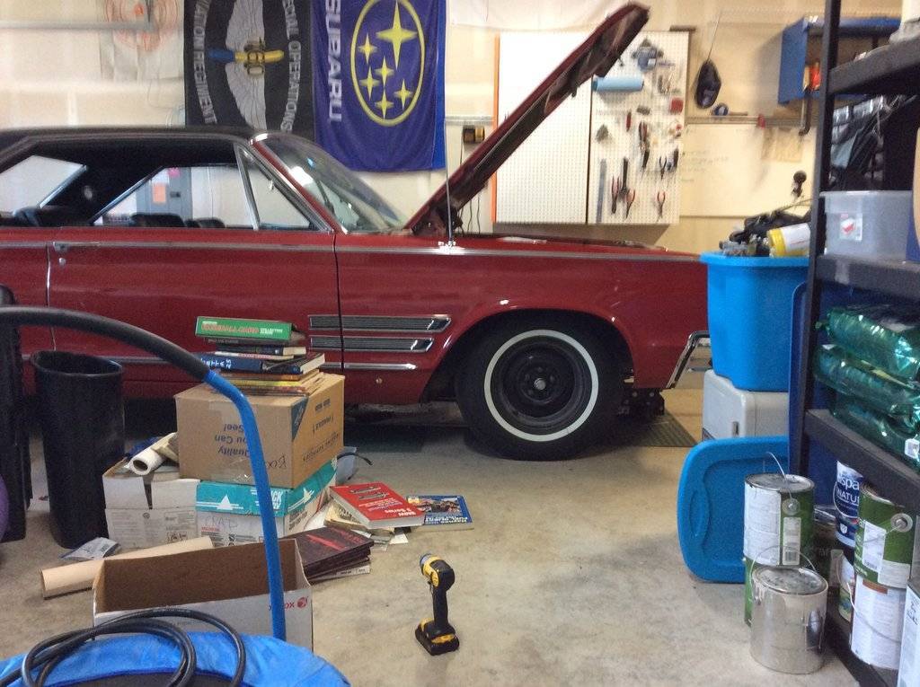

I'm seriously considering an EFI for my Imp., how much did you end up spending soup to nuts?
Soup to nuts I'm close to $1800. But $300 of that is a new tank because mine was seriously nasty in the inside. I didn't want to run crap through the pump. I guess I could have found a tank from a b body maybe that would've been smaller capacity through tanks inc but I wanted to be able to run the carb again if I ever sell her.
Can you use the stock air cleaner for that "OEM" look?
In theory yes. I need to punch widen the diameter of the opening to 5 1/2 I believe. Stock on our cars is 4 3/4? Don't quote me on that yet. I will be running the stock airfilter soon enough though.

  1. Please let us know how that Robb canister works in tight turns, if it prevents fuel starvation to the EFI, and if there are any quality issues. It's $100 cheaper than the surge tank that FITech is selling, so Robb is on my radar if I ever get around to EFI.
  2. Please move that canister closer to the radiator, it's a little vulnerable if you get in a fender-bender.
  3. Swap out that plastic fuel filter for a standard metal type. That plastic filter, and the glass-tube style that Mr Gasket et al sell, should not be on any of our cars.
  4. I see you have 'the shiny spot' on your water pump pulley. Your PS belt has caused that, ping back if you need more explanation
Yes please explain the shiny spot if you can.
On to your questions fury fan.
1. Don't bother with the fitech FCC. I haven't come across many people that have had good luck with them. It's dead headed to the TB (which I believe is 90% of their problem) and has a smaller capacity than the robbmc unit. The Robbmc unit is a beautifully designed piece.
2. I took that into consideration and decided that not having it too close to the radiator was worth it.
3. I fully intend on swapping to an all metal filter. I just wanted to make sure there was not left over debris floating around before I do. I'm also going to run that fuel line differently.
For the record, the AFB and large 2-barrel necks are 4-1/2" dia, the AVS, TQ, and modern 4-barrels are 5-1/8" dia.
The shiny sport comes from a rubber bumper missing from the PS pump bracket, which allows some slop in the PS belt, and it flops against the water pulley. Shove a suitable piece of rubber or wood down in there and re-adjust the belt. Or swap the a newer-style of bracket (make sure the bracket fits the pump).

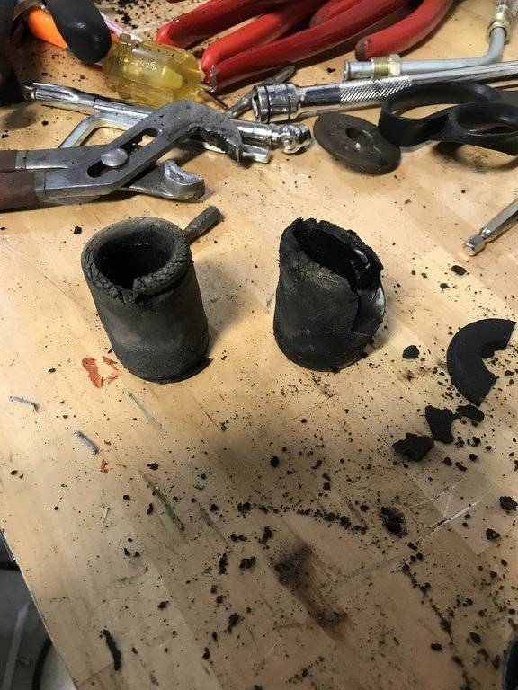

Pic of the left and right lower control arm bushings. I'm no sure they were ever done.

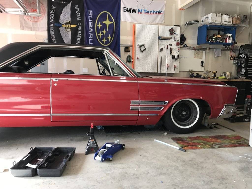

Got everything finished up with the suspension. I just need to adjust the ride height now. She's sitting a bit low in the front at the moment. What's the preferred method? The FSM is pretty vague saying to place a load on the torsion bar and then adjust until the measurements are within 1/8 inch between the two spots on the LCA. I think I read somewhere on here that said something like 30 turns or so on the adjustment bolt.
I'm generally not the guy that likeS the slammed look at all, but looking at her in the garage with all that forward rake is kinda cool.
I'd say this looks about right.
One thing I'm sure of is that a contortionist couldn't get to the brake cylinder bleeders. That's the last thing I need to do is bleed the brakes because I replaced the rubber lines while I was in there.

As long as you're in there, I'd set it to factory ride height. The method is pretty simple. Measuring two spots on the suspension/chassis and making the difference be within a range. I found my car drive noticeably nicer at the proper ride height. Lowered looks cool but I'd start out at factory height and see if you want to change from there.

I've been playing around with ride height a bit and I am going to bump it up a hair more.
