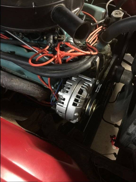

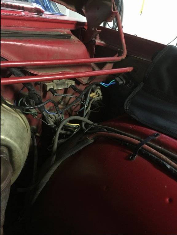

Slowly getting the car ready for its Sniper EFI transition. In the last month I've replaced all the ball joints and tie rod ends....fun jobs indeed. Then over Christmas, I replaced the old single field alternator with a dual field and solid state voltage regulator. Almost the easiest upgrade I've ever done. No more dimming lights and my ameter stays dead in the center for the most part.
Also during Christmas I tossed in a pertronix igniter 3 and flamethrower coil. Wow what a difference. The car feels really snappy now. Don't mind the ballast resistor in the pics, I just got rid of the resistor and put a wire in between he terminals to keep a stock looking appearence.
Maybe soon I'll get the sniper installed. Kids and work equal not much playtime in the garage.
I trimmed the VR slightly and mounted it where the torision bars are. It's clean and easy. I made an extra ground just in case too.
