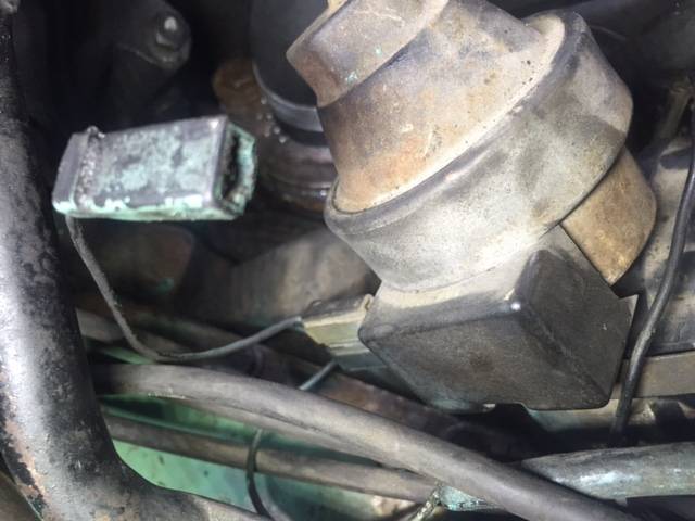

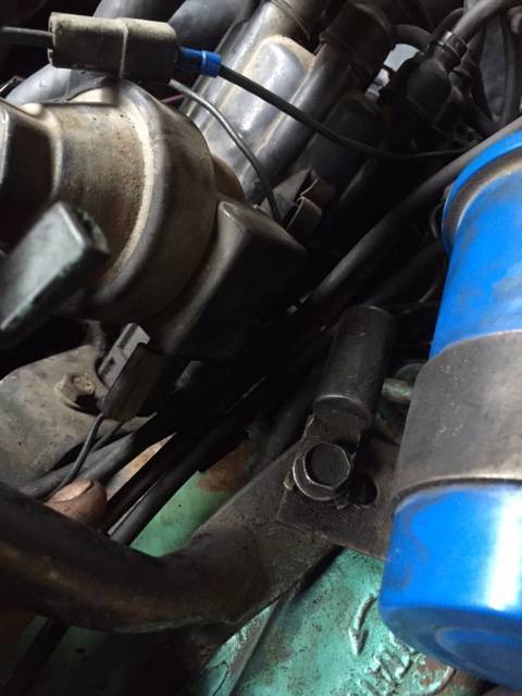

Can somebody tell me where I need connect this loose wire that is coming from the electronic vacuum advance unit?
The other wire that is connected to this vacuum advance unit is coming from the coil.
1970 chrysler 300
Thank you.

One wire goes to the carb. There's a place to connect it to the idle stop or whatever it's called (if engine still has original carb). It grounds while the engine is idling.
okay, now I understand. I think it has the original carb, but hasnt got the "idle stop". But is connected with the small hose which does more or less the same thing. Thanks Pieter
I just found out. Its the fast idle solenoid, which I do not have anymore. The rest is original.
Somewhere in the general area of the red circle there's an adjustment screw that bottoms against a stop. There should be a tab for the wire connector to attach.
