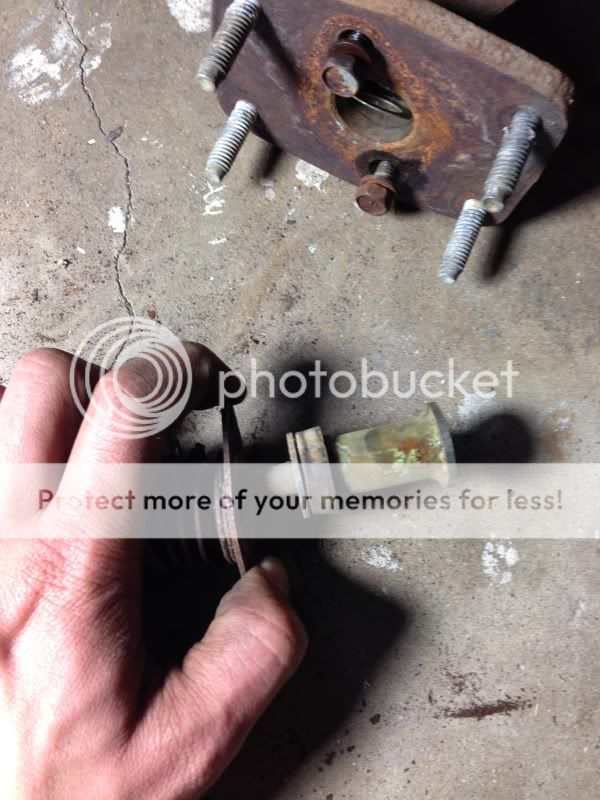

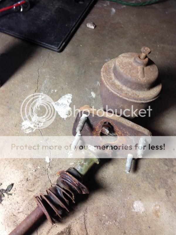

OK.. See the greenish aluminum part on the end?? That's the piston that you pulled out of the old master cylinder.
That's junk.... Take it off the push rod.
See the spring, retainer and diaphragm just behind the piston? Also junk from the old master cylinder. Take them off too.
You new master cylinder will have those parts.
Look at the back of the mounting face of the master cylinder. See the two bolts? You didn't need to take that apart. All you had to do was yank the pushrod out.
In fact... I would have never removed the pushrod from the car. I would have taken the master cylinder off and replaced it with the new one.

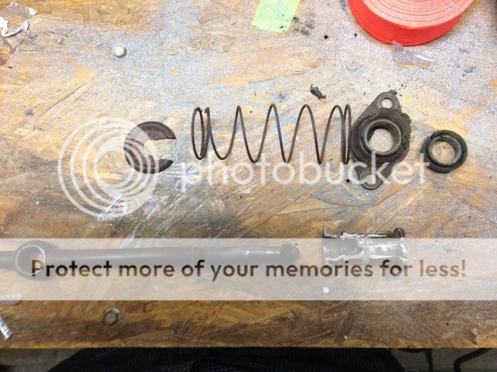

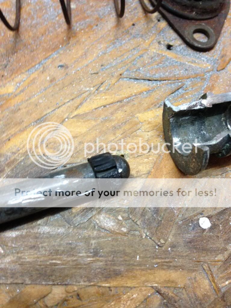

ok, progress has been slow with work. last night I managed to cut the piston off of the push rod.
question about the little rubber ring around it.
This is what holds the pushrod in, right? I put a couple of cuts in mine when cutting off the piston. Its still on there with a few nicks, is it ok to use this as is? if not is this a part that can be bought locally?
I have used a piece of fuel line and made a new one, something I had in the toolbox.
Alan
