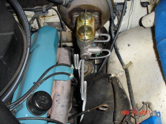

converting to dual piston Master Cylinder
Brakes
You can not see it in the pic ,but I just used a flare pug with red lock tite to block the rear port and then just put a union in from the master cylinder line to the rear brake line. I hit the yards to find flare nuts for the m/c so no adapters where used.
Yes still has air start at rt rear/furthest, left rear, rt front, left front. With a helper pump it, hold, squirt.
