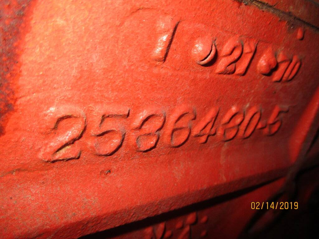

2536430 is the casting number of a 440 from 1966-72.
They started putting the cubic inch size after the part number in 1973.
So it would be 7 digits then 440 then a number
XXXXXXX-440-X

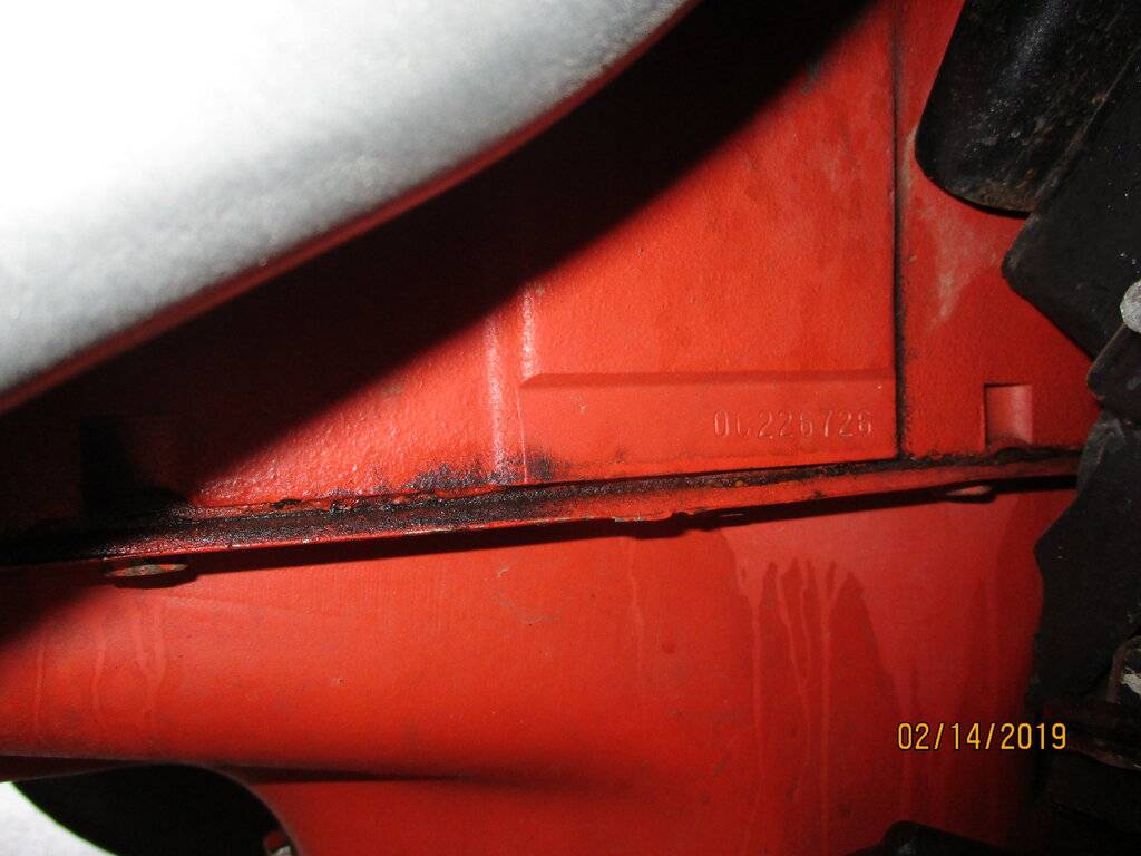

Here's my casting number, and my car is numbers-matching:

So I have the engine stamping number off of the front right pad, and it’s a strange one!
it gas 2 rows; 1st row reads
F 440 (Maltese cross) X
second row reads
7 15 Backwards B
Does this make any sense? Weirdest stamping number I have ever seen!
F 440 = 1970 440
Maltese Cross might be under or oversized bearings, but you could look that up
7 15 = July 15. Coordinate this with the scheduled build date in the fender tag.
