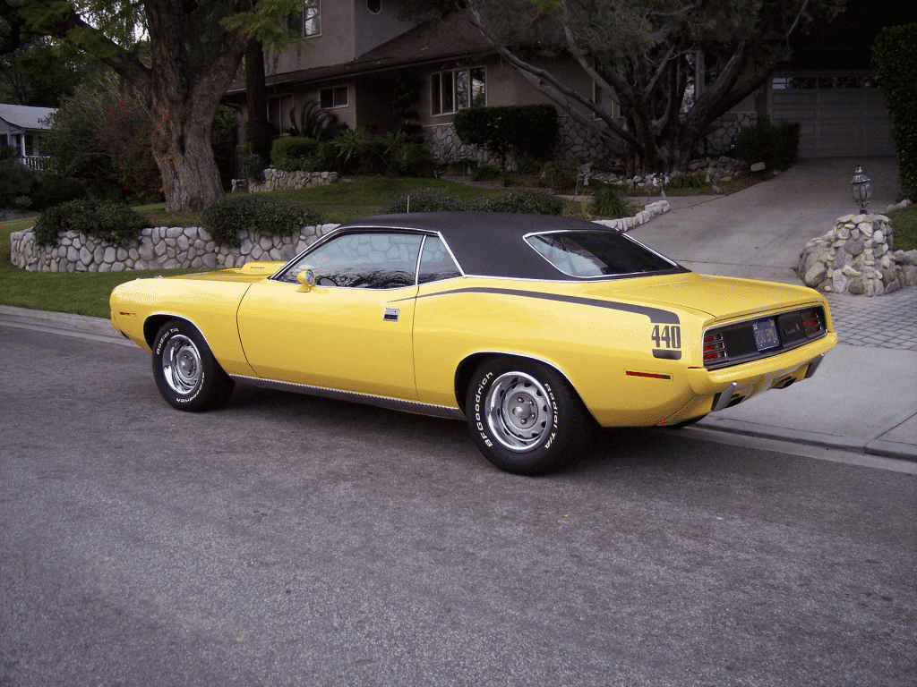

I do have a 70 Cuda 6 pack and that thing is downright dangerous in the wrong hands especially with its very light rear end compared to the front end. For those who haven't seen it before, here is a photo of the one I restored many years ago now......................................
It still looks the same today as in the photos since I don't drive it that much given how tempting it is and it rides like a buckboard compared to our C bodies. It also has a 3.55 rear end that doesn't help things either when driving down the freeways and the engine is spinning at pretty high revs in that mode too. But its stock exhaust is still pretty quiet but not as quiet as C bodies.

@saforwardlook Just curious, you said restored, The shaker is yellow, the rear bumper is a painted bumper and the interior door panels are for a gran coupe. Was your car originally a BP car and just had a few liberties taken? Probably an N code?

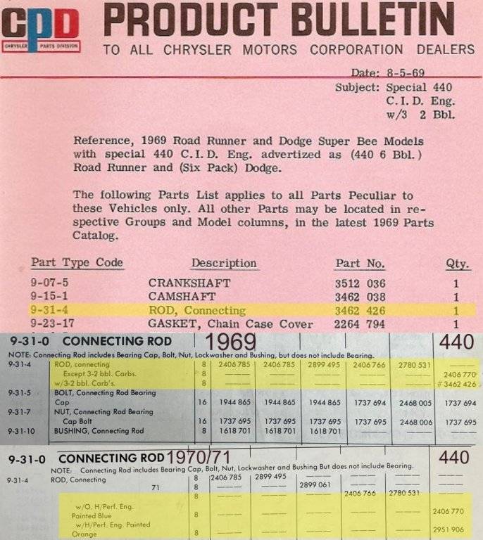

Factory documents are always a great place to start to clear up repeated misinformation or clarify applications.
The 1969 6bbl rods carried a different part number than regular 440 rods. (Notice there is no difference in standard PN 2406770 440 rods or HP application for 1969. Rods are rods). The PN3462426 were treated differently than other 440 rods (Were they magnifluxed? Still trying to find the documentation as to why they have a different part number)
So for 69, there are "six pack rods" as there were rods specific to the 6bbl assembly.
In 1970, and 1971 as applicable, the same rods used in 1969 HP and non HP applications are listed as the correct rods for 1970 NON HP applications. PN 2406770
There are rods listed for orange HP applications for 1970. This would include both 440-4bbl and 440-6bbl applications. PN2951906
So for 1970 and 71 (72?), there really are no rods exclusive to a 6bbl application.
The term 'six pack rods' can really only be applied to the specific application rods for 1969.

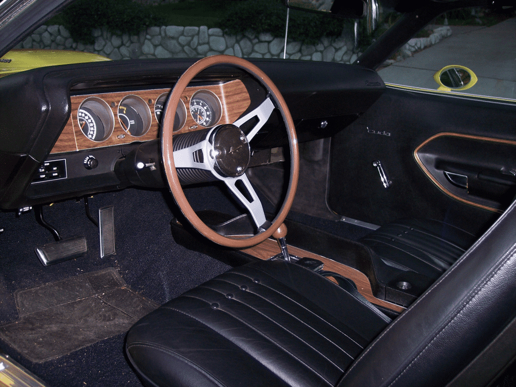

My car was an original 33K mile Cuda with its original numbers matching 6 pack engine in it and its original VIN was still in place verifying its original 6 pack status. You are correct, as the shaker bubble was normally argent silver but I preferred yellow to more easily keep it looking clean. The problem with the car is it was missing its body code plate so I just built it as I would have optioned it if I could have since the missing body code plate (and no build sheet either) made the car substantially less valuable so I just took the liberties. I put in the overhead console, the leather bucket seats/Gran Coupe door panels, etc. and other upgrades such as the Elastometric rubber coated bumpers as I would have wanted if I had ordered the car. I am not heavily into E bodies like I am into C bodies so I decided to do this one differently.
The car was originally B5 blue as best I can discern and had a white vinyl top and bucket seat interior and bereft of any options. It was damn fast, but otherwise it rides badly, is noisy, handles not that well, bucket seats are not comfortable (has the 6 way manual ones too). Rather than use the word "restored" I should have said "made it like new".............
