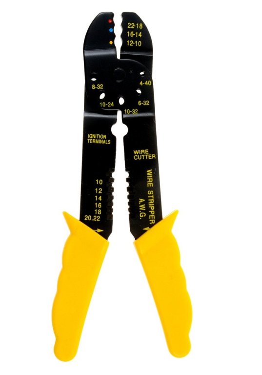

Don't have one of these in your toolbox? (only $6 online)
